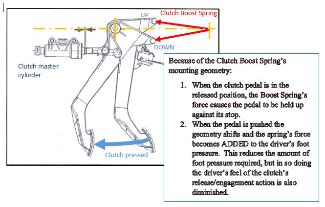

The logic of this is . So if you read what I initially said, I'll go ahead rephrase it for you, MY spring snapped while I was driving and has become overly stiff to the point where I can't feel my clutch engaging or disengaging. Due to this, not because of your statement of being a "***** driver", I have replaced my spring. Of course the clutch helper spring was to hit a larger market of drivers who don't prefer to drive a stick.... ***** drivers I guess as you would say.

Why the pedal pressure changed when spring broke
Attached helps illustrate how the Clutch Boost Spring effects the force required to actuate the clutch pedal. A broken spring would act like a very light or missing boost spring.
Porsche selects from several different springs depending on the vehicle's configurations. For example, a heaver boost spring in a Turbo because of its heavy duty clutch. I know of 3 different color-coded OEM springs; purple, white, orange.
