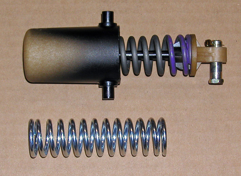

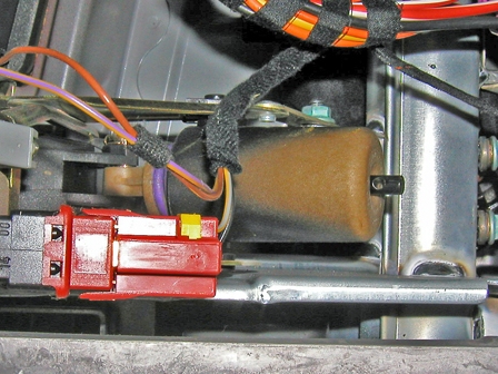

Here's a photo of the assembly still installed in the car and showing where the rod can extend out the end of the housing. You move the clutch pedal until you can insert a small nail through the hole, then reposition the pedal as needed to release tension on the assembly's pivots so that you can remove.
Use caution when you dismantle the assembly because the OEM spring has considerable tension when compressed. Obviously if your spring is broken this may be much easier.
Second photo shows the OEM spring and the much lighter alternative from McMaster Carr mentioned in the earlier post.
