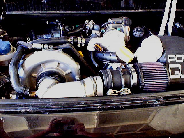

Problems
Originally Posted by 1999Porsche911
Did you ever mod the MAF and get your car started?
Yes/No, I got the resistors but found some intake problems, cracked intercooler coupling/reducer. New re-enforced throttle body reducers ordered with new T-Clamps still awaiting parts. I did not like the intake and did not trust it so I fabbed up a new one this picture is beginning of it and have not taken pic of finished one but it is installed. I will get new numbers soon and post. The reason for the AFR is that after these new mods I will have no idea where the mix is, I'm sure it will still be rich but just concerned. I would like to get the AFR ordered ASAP.
