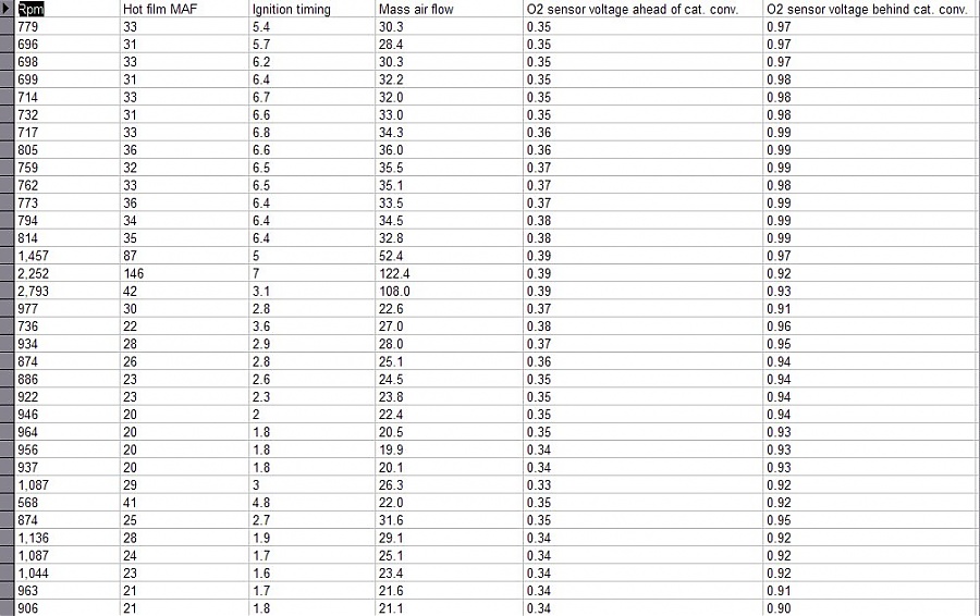

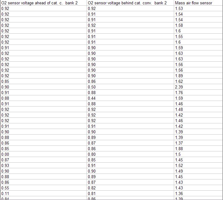

Well the car runs 100% better and does idle, no hunting or smoke with new intake and the $1.00 resistor, but still seems alittle rough with no misfires indicated. I cannot remember, but I think I had a error message with one of the O2's and will re check later just wanted to tell eveyone that helped thank you and GOOD JOB! The new info was sent to FVD and we will see what they think. 1999 not sure which O2 voltages after cats since there only seemed to be the one for right and left banks (Conv) but seemed one bank running very lean hope this is what you where talking about, if I missed something let me know I can get more data. Attached in 2 parts are the new numbers that will lend some indication of what the engine is doing pluse new crappy video and Excel spead sheet at:

Update
Ok, an update the new (bank 1 O2 before cat) sensor has be installed and car runs better and Error Code 1115 I had previously has cleared. It seems rich at idle but leaner once warm and the numbers (O2 V) seem better, but lean after cats? Note: On image first votages are of bank 1. Feeling more I confindent drove it down street at idle but have a "CLICKING" noise that seems to be comming from wheels on both sides, I had redone the brakes with new pads so I still am not ready for Dyno I made a video of the sound tell me what you think:

I just posted what you need to do over on Rennlist. You are not running lean. You need to plot some WOT after cat sensor readings. MAF voltage still too high.
