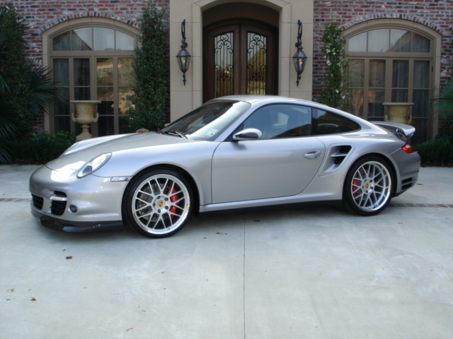

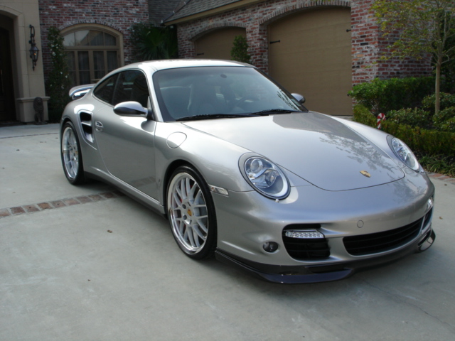

I have had the P2S's on my car from Brand new and they work excellent on the road and track. I have the 245/30 ZR-20 on the fronts and 325/25 ZR-20 on the rears. This wheel and tire combination are almost identical overall diameter as the factory OEM tires.
Max
P.S. If you would like I could furnish you with some pictures

If you would like I could email you a picture? I believe they look great.
