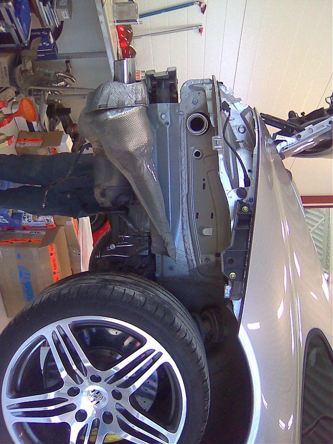

Update:
Today I ordered EVOMS EVT700 for my TT Tiptronic, maybe I am frist Tip to have it in Europe???
Anyway, it was not nice to see my car beeing torn down with only 14 tkm's on it
Today I shipped VTG's & ECU to USA, should arrive there 8th of may.
My goal is to get car in one part by the end of this month, we will have to wait & see if this happens!
Well, the good news is that KW's arrive tomorrow, so I am able to do all the mods same time!
Also, new brake pads & brake fluid are on the order, Motorsport pads/ Castrol :
