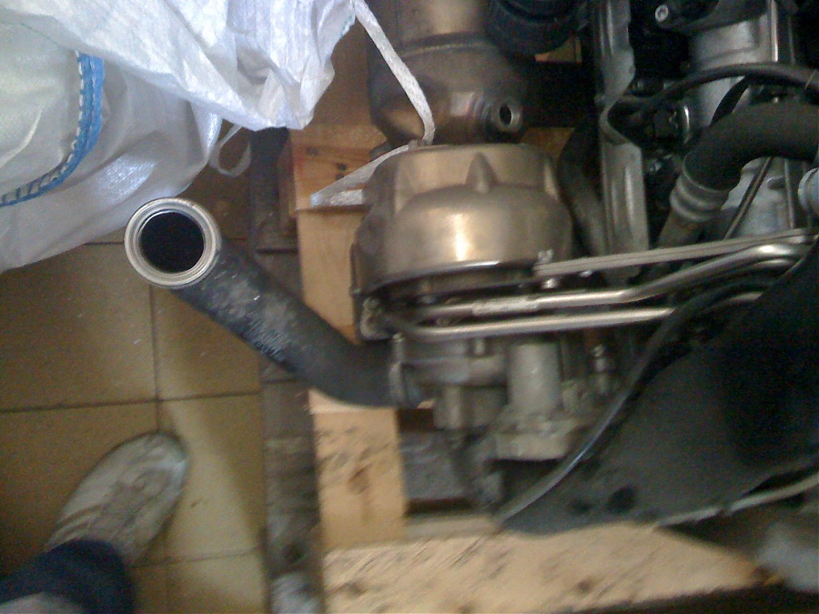

I would like to know from 997gt3/TT the result using gt2 turbos, do you really appreciate a big difference, less turbo leg? I would like to change my stock turbos and now I must choose.
My 997 it's in progress:
Gt2 front and rear
Bilstein Pss9
ecu
techart sway bars
evos intercooler
idplenum
techart full exhaust

You pulled an engine to put on a plenum and an exhaust?

No, my car was bumped with a damage to all the rear left part included the suspension. To do a nice job we decided to pull the engine. The insurance of the other car involved in the incident will not be happy.....
In any case a friend of mine has a 997 GT2 with ecu ( digitaltunig) and racing exh. (www.superspint.it) and it really fly, from 2000 to 7200 rpm the engine pulls in a great way . Very low turbo lag, so i'm wandering if the gt2 turbos is a good choice . I tried a friend car ( now he sold the TT for the Gt2 ) with evoms kit ( he gived to me the intercooler and the idplenum ) with modifyed turbo, the Gt2 engine it's better.
