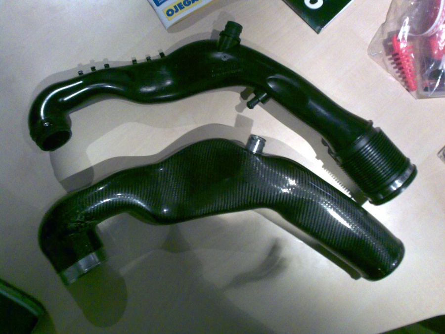

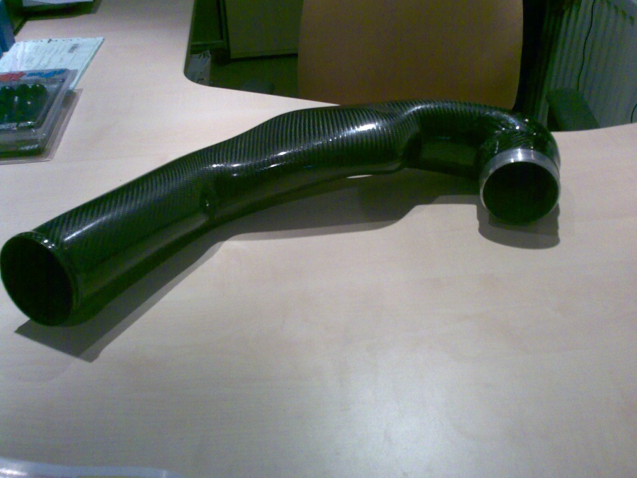

997 GT3 RS/TT has a reputation beyond repute997 GT3 RS/TT has a reputation beyond repute997 GT3 RS/TT has a reputation beyond repute997 GT3 RS/TT has a reputation beyond repute997 GT3 RS/TT has a reputation beyond repute997 GT3 RS/TT has a reputation beyond repute997 GT3 RS/TT has a reputation beyond repute997 GT3 RS/TT has a reputation beyond repute997 GT3 RS/TT has a reputation beyond repute997 GT3 RS/TT has a reputation beyond repute997 GT3 RS/TT has a reputation beyond repute
I'm ready to show my new carbon/aluminum air pipes for garrett turbines.

Originally Posted by 997 GT3 RS/TT
any chance for the pictures of your pipes, soon I will show mine
I think i have pictures to that pipes what we made but check and cant find them, anyway they havent nothing to compare with your pipes, your looks sweet, our are only for problem free work because 9ff pipes crack a lot But if i found the pictures in any of my computers i will send you them no problem
