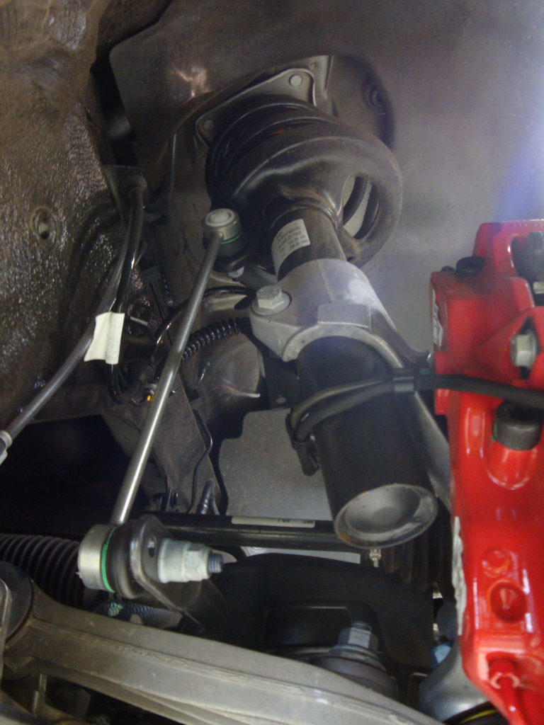

Actually,
Taking a detailed look at my installation and BBI, there's actually some differences!
Which is very helpful to me, because I'm sure I'm the one that has it wrong
You can see the differences.
Also, VID997, would you be able to give me information on who did your installation so I can maybe contact them tomorrow and ask them about mine?
Thank you very much!

The drop link has to be installed on the outside of the sway bar (towards the wheel). The rubber you see at the ends of my drop links are dust boots which seal out dirt and moisture from the heim joints.
cannga,
Thank you!
I still have some doubts because from Powderhound's pictures, his Drop Link is also installed outwards, towards the wheel. But his seems to be different, it seems to have rubber at the bottom connection, while mine is bearings?
I'm not sure if I got it wrong or if it's possible to get wrong, but I might give it a try to check what happens!

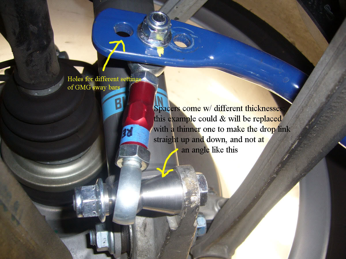

With regards to drop link placement on the sway bar, in the end it all depends on what type of bars you have, exact suspension set up, alignment, ride height, etc, etc. Each case is different and that is the reason installations may vary. In the end, you need to make sure that everything has clearance through the full range of suspension motion and steering angles. One thing I did after the install is wrap the drop links and sway bar with blue painters tape and drive the car for a day or so. This is easy to do and will show you if you are rubbing on anything anywhere.

OK so I had my car on the lift today, and I've been talking to Joey at BBC Auto sport.
He's been very helpful and has cleared a lot of confusion for me through pictures.
It seems that these kind of suspensión is about playing with the Sway bar position a lot.
If it's too high, it will hit against the axle, happened to me.
If it's too low, it will hit against the lower Control arm, happened to me too.
Causing big clunk noises.
The springs are supposed to make certain noises like ''String'' noises, this is normal, and can be avoided with special bearings.
Right now I set my car like Joey told me, and I wrapped the sway bar, and axle in painter tape to see if it keeps hitting.
I would also like to mention that if anyone is thinking of getting a suspensión like this or motón, make sure you have a professional installer OR very very VERY good tech support.
I didn't have either one of them. We don't have shops for this here.
I'll keep everyone updated if things happen!
Mario, in case you don't already know, Tarret also has different cone washer thicknesses for adjustment of the drop link (see pic below) to make the connection as perpendicular as possible, etc., and just in case, that might help with any clearance problem you have. Call them if you have any question at all - Ira (?) knows a lot and probably would have some great suggestions also.
