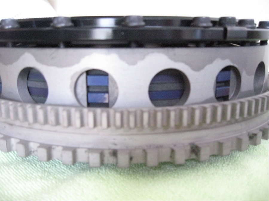

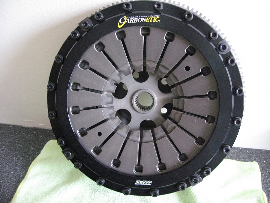

That setup is one of the best and feels close to stock as one could want. Should not slip under your feet. It will need to get broken in before you hit it hard. Give it 300 miles. If you hit boost before the 300 miles, only in 4<SUP>th</SUP> or 5<SUP>th</SUP> and when the clutch is sufficiently hot. fficeffice" /><O></O>
<O> </O>

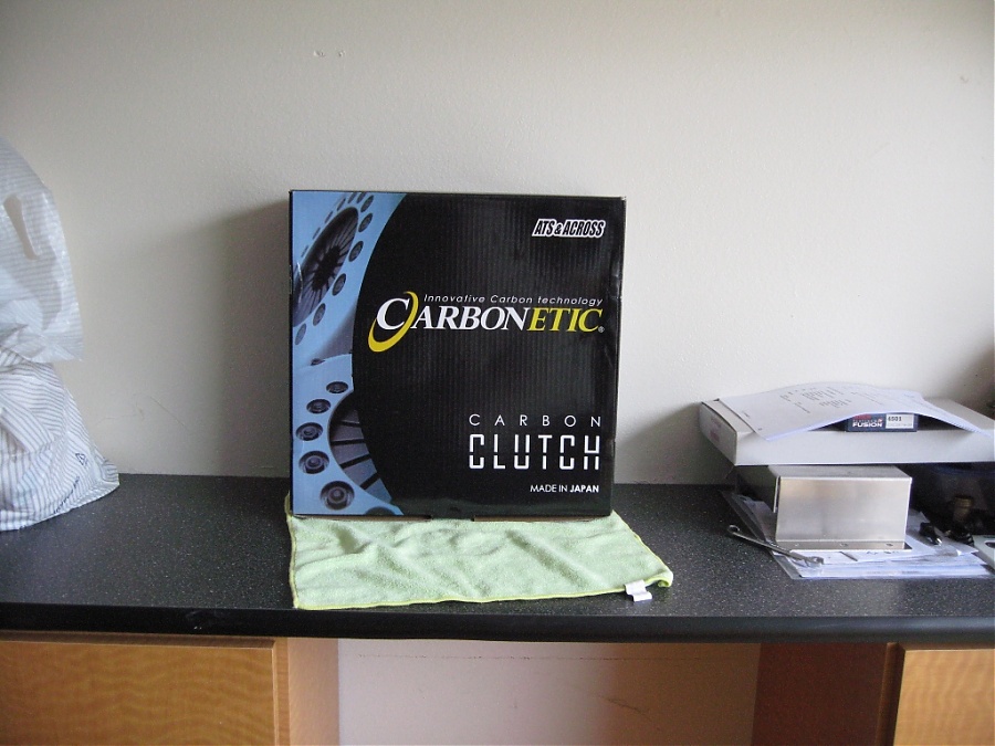

Attached is the clutch I purchased. Carbonetics Triple Disk. Way overkill but I got a good deal on it. 11lb LWFW is the bomb! <O></O>

I have seen it in action - as you sped by me. It's sweet.

My triple is not hard to depress (no different from the stock clutch). It has an on/off feel, top of pedal engaement, and is noisy.
