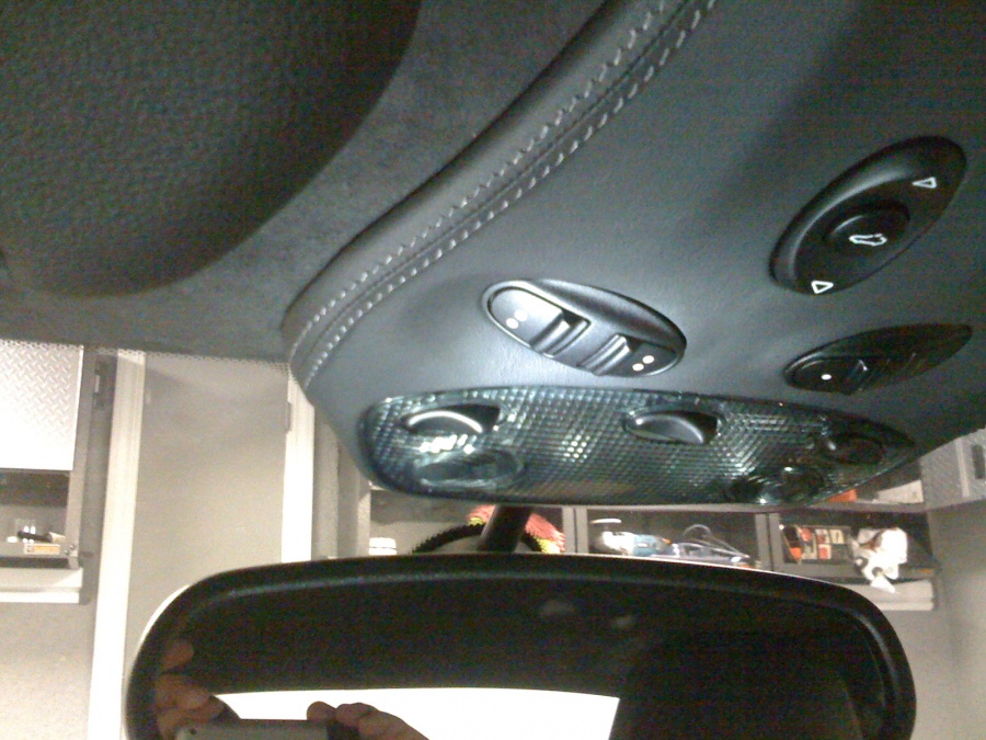

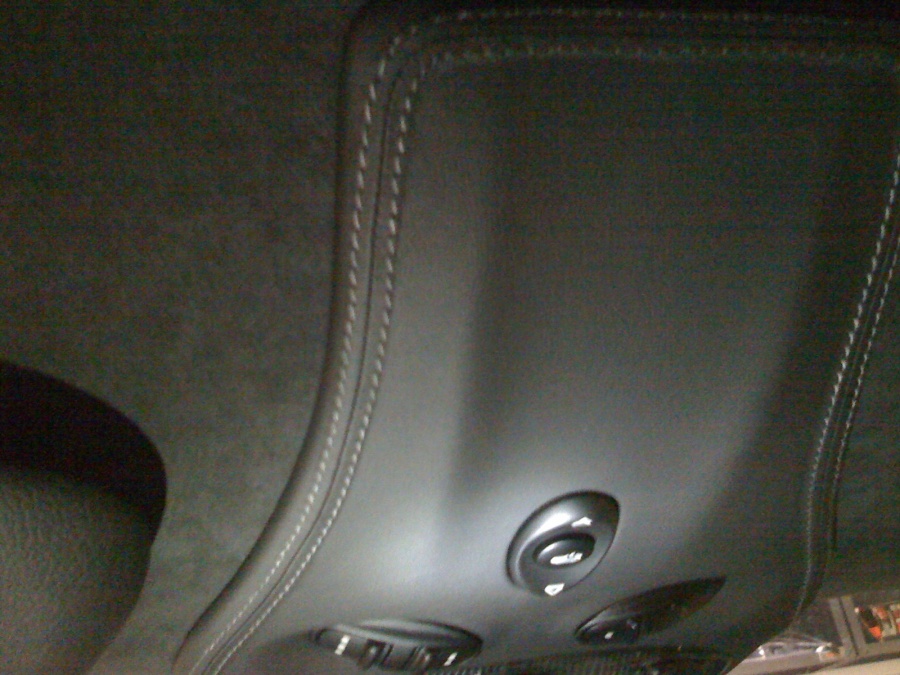

Yes...it comes with stitching!
Sorry...crappy for the crappy iphone pics.
First, remove the old dome light cover.
1. Pry out homelink buttons...there are a pair...one for the LED and button 1, and one for buttons 2 and 3. If the button falls apart, don't worry...they are easy to reassemble. No screw drivers...just my fingernail was enough to pry them off.
Old Nov 21, 2008 | 06:22 PM
bbywu's Avatar
Posts: 10,774
From: OR Room 5
Rep Power: 1007
Then, unscrew the two phillips head screws...
Old Nov 21, 2008 | 06:24 PM
bbywu's Avatar
Posts: 10,774
From: OR Room 5
Rep Power: 1007
Disconnect the lighting panel, and pull down on the dome light cover.
Next, disconnect the homelink wiring harnesses (2) and sunroof harness.
Transfer the sunroof button to the new dome light cover, and reverse the process.
Total time = 10 minutes...and I was going extra slow and careful.

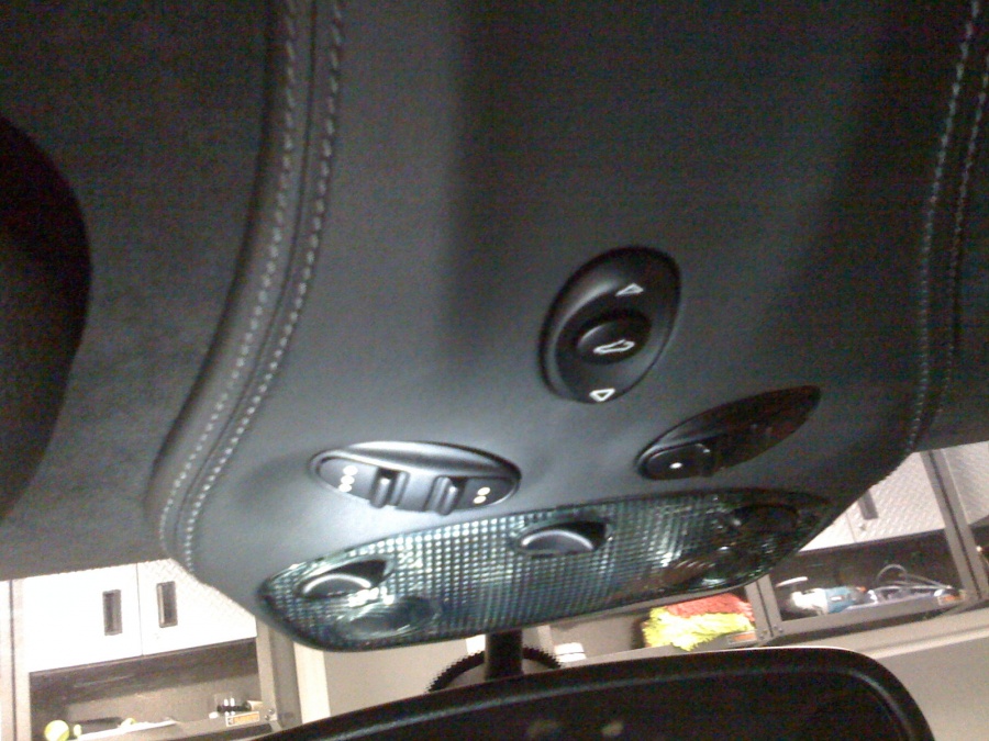

Finally...

Originally Posted by BSM
Bob - nice work! Looks awesome.
I'm convinced, ordering it from SunCoast on Monday.
Thanks.
I really should have done it when I ordered my car. I splurged and did my own "economic stimulus package" to Germany...steering wheel cover, dome light cover, visors and leather door entry sills.
If you need a hand, let me know. The only hints I have are:
1. Phillips head screws are very tight...I used a ratcheting socket wrench with a phillips head adapter to get enough torque without stripping the screw...it was very tight.
2. Transferring the sunroof control required a little bit of un-nerving force to pull it out of the original dome light cover.
Everything else is easy...the harnesses only plug in one direction.

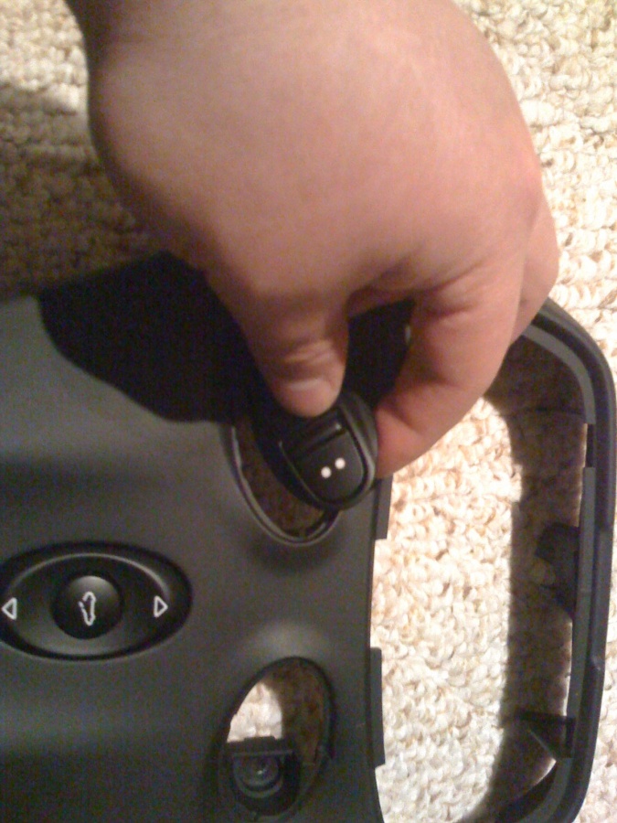

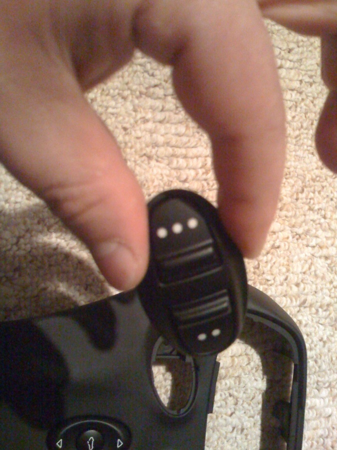

Removing the Homelink buttons were tricky! I used my fingernails and the first one went flying everywhere! 4 pieces! I was a little more careful with the second one so this one didn't come off. I had to remove the inner pieces too. Once those were off, I unplugged the two buttons and this is what it looked like:
It was tricky to get these buttons put back together but this is what they should look like:

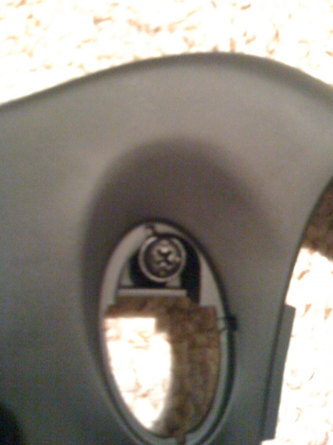

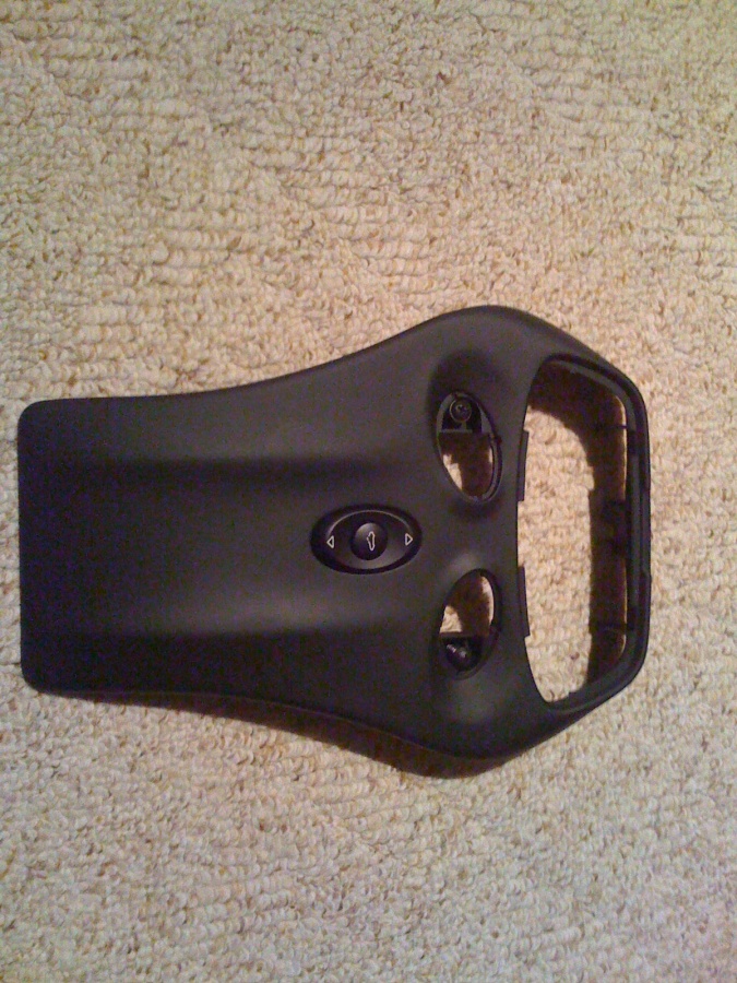

To get the cover off, unscrew the two Philips screws visible through the holes and gently pull the cover off using the two holes. And this is what it looks like without a cover:

Reattach the Homelink modules making sure to put it in all the way:
It's tricky getting the modules back into place. Don't be afraid to use a little force. It might fall apart again but keep trying and it'll look like this afterwards:
All done!
