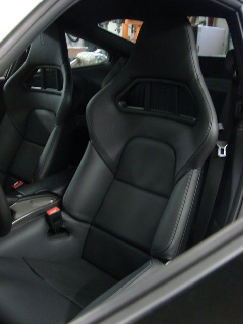

Installing 997 GT2 seats (with airbags) are easy, and does NOT throw codes (we disconnected the battery). There are are some pros and cons:
Pros
  • Weight savings (stock 997TT seat weighs 66 lbs., GT2 seat is 37 lbs. each)
  • Cool looking
Cons
  • Seat does not tilt forward or back, does not go up/down (only slides forward and back)
  • Limits legroom (factory seat moves back further)

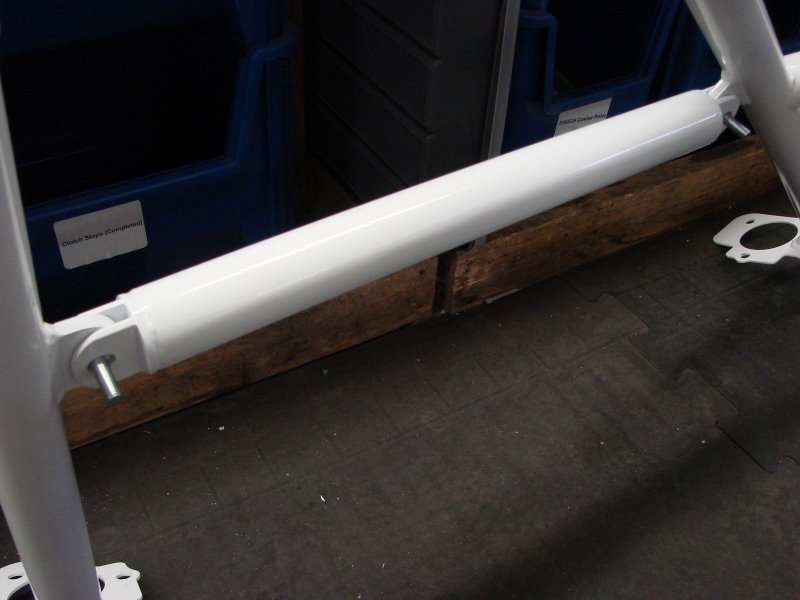

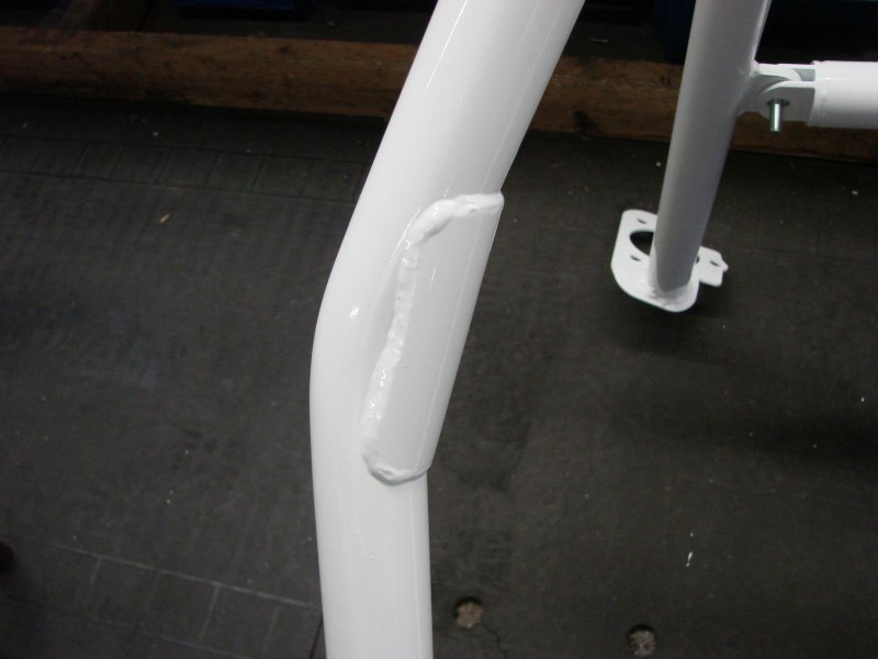

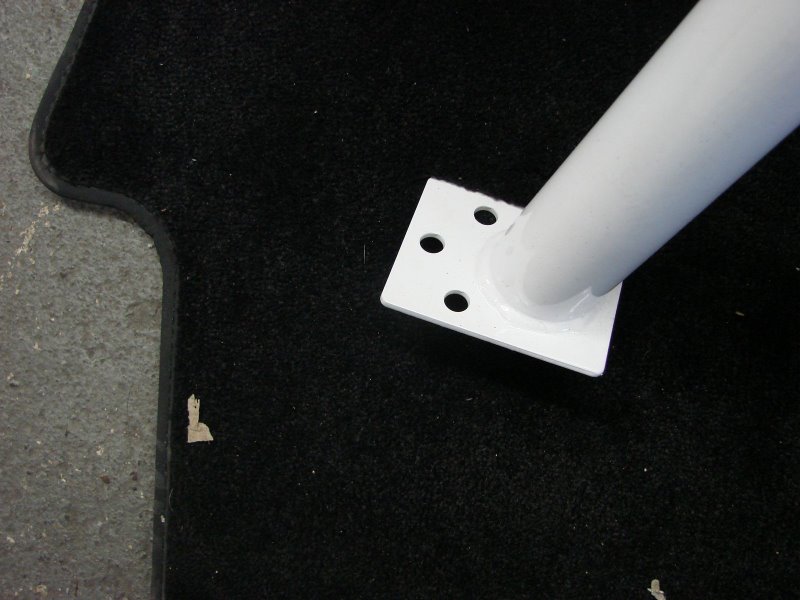

Some pics of the seats (installed) and the beautiful, factory GT3 RS roll bar (obviously, not installed).
We had it blasted and powdercoated white.

More pics of the roll bar.

$2200 is list price, without the powdercoat change. We will also include a set of stainless floor brackets (which is not included with the bar from the factory, for some reason).

Nice seats. They were advertised to be able to fold for rear seat access. Don't they?
Yes, they do fold foward for rear seat access. Then again, after seeing the size of the rear seats, it hardly seems worth the effort.
Cool seats, nonetheless.

Are the seats comfortable?
The seats are firm, but according to the owner of the car, he liked them when he tried them in a GT2 (in a showroom).
