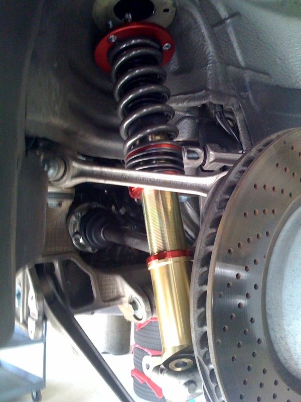

Upgrading from PSS10 to JIC Cross, write up, details and pics...
I posted on here before about wanting to upgrade the suspension on the 997TT, I went with PSS10 + GMG sway bars, car rode fine, just don't take corners too fast and it was bouncy and not to forget, a bit too much squatting on some cornering.
I decided to research going with stiffer spring rates and keep the PSS10's as they are compatible with the PASM system.
I order a set of H&R springs with about 686 rear and 570 front, as i was about to get them installed, i realized that the PSS10's valving is not something you can work with to accommodate stiffer spring without changing out the valves it will affect the dampening on them period so it would be a compromise...
Car on the lift, i called Vivid Racing, told them about the issue and they overnighted me a set of JIC Cross to check out...
Next morning i take the JIC's over to the shop and we get working...
Install was not easy and strait forward, it was different, nothing like the PSS10's they are fully adjustable ride height is a bit tricky but we got it all on until we ran into a small problem. One of the rear dampeners was somehow damaged while it was assembled. I got on the phone again with Vivid Racing, put me on a conference call with JIC Cross, another dampener is on the way via overnight at no cost...
New dampener comes it, we re-assembled the strut, adjust ride height...
We ran into another small problem... the sway bar links that came with the JIC's did not fit right, they were about 3/4 inch too long and the instructions were to turn the strut at an angle that will not allow the link to line up perpendicularly with the sway bar, it put a lot of pressure and overloaded the sway bars, so i ended up using the PSS10 links as they fit on perfect.
We drove the car around, let the suspension settle down a bit, back on the alignment rack, made sure the ride height is still in check, made a couple more adjustments and it was all perfect!
I went ahead and had the TT aligned to Gt2 specs per Vivid Racing's recommendation...
What a car!! it drives very different like a completely different car. the springs are quite a bit stiffer than PSS10's but there is no suspension noise, no hopping, no bouncing and the best part of all, smooth on rough roads you do not feel much at all.
I have the dampeners tuned to 10 clicks in the rear and 4 in the front, i weigh 250LBS so you need to adjust your car to your preference and the type of ride you are looking for.
Aligment is set at -1.5 front and -1.7 rear camber, sterring is very responsive and much better feel.
Over all, this suspension is the best i ever had, car has almost no body roll at all to the point i took a test drive on a local highway (183) taking a wide corner going through a ramp at 128MPH car felt like it's going 60.
JIC were great and provided the tech plenty of assistance and support, Vivid Racing got about 20 calls a day from me and assist me all the way and i have to say I will always buy from them and i am having them custom make me a set of JIC's for my 2008 C6 that currently is running a set of PFadt Racing coils on it.
I started with a decent set up, needed stiffer springs, I realized that I should have waited longer and researched some more before I installed anything but it was a learning experience and I am quite pleased with the results even though I ended up paying for an additional 4 hours on my bill due to the faulty Dampener.
Here are some pictures and a link if you want to get more info:
http://www.vividracing.com/forums/ga...p?c=341&userid=

pics
