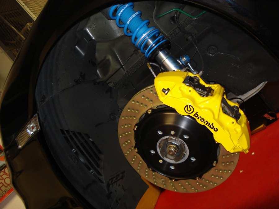

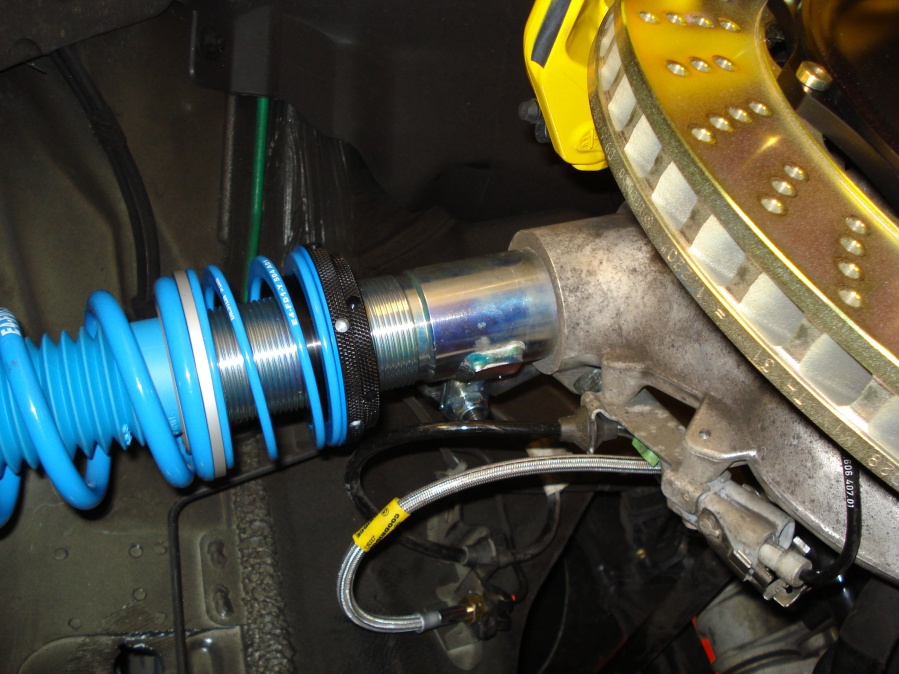

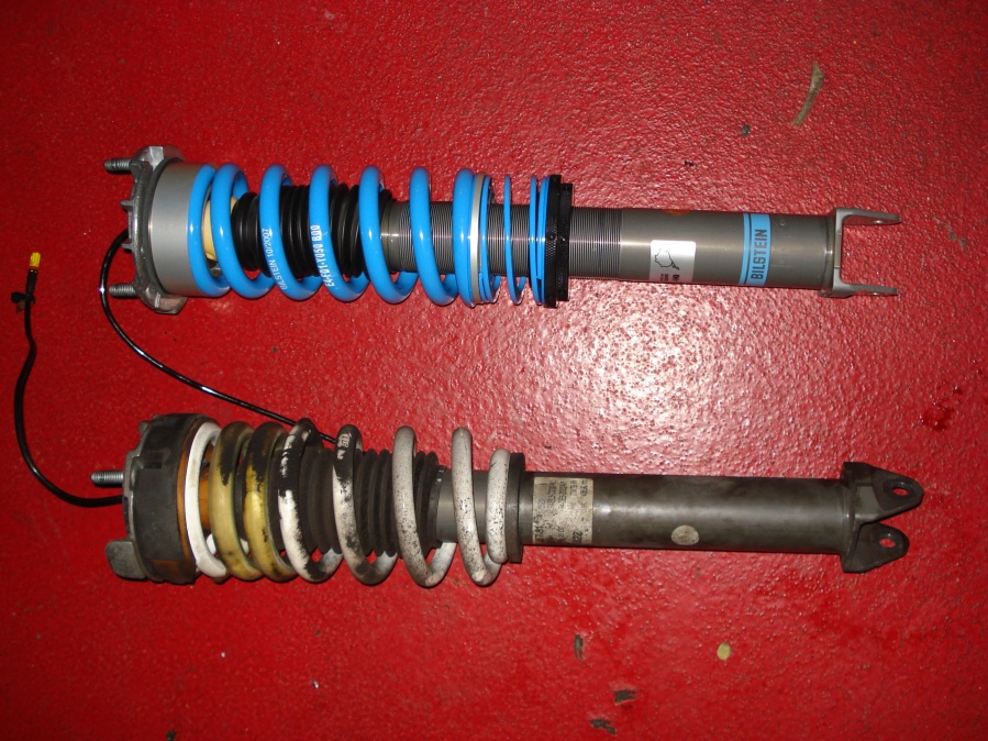

I have the pss10 damtronic setup . Here's a pic next to my old techart as well as installation photos. Yes ..I am referring to slow speed bounce (ie traffic) .
