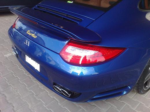

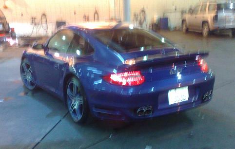

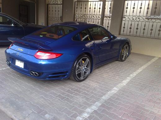

Originally Posted by Porsh997TT
love what you've done to ur 996
found some pics of a 997tt with the facelift LED tail lights

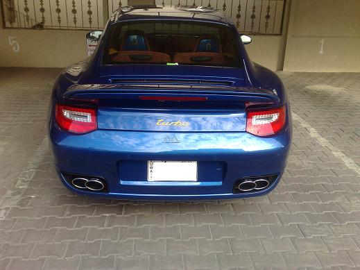

more photos of the same car i think you got them for elashum alqa6areya as i post them long time ago..

sorry for the bad quality photos phone camera..
