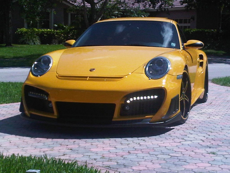

Porsche 997TT with GT Street RS front bumper
I want to share these pics with you guys..i just installed the Gt Street Rs front bumper on my Turbo..
