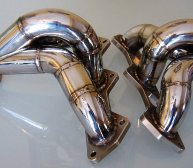

Originally Posted by skandalis447
As an engineer i can tell you that outside welding of the photos of these headers is just good...But not a state of the art...weldings are too thick...if the steel of the header has a thickness of e.g. 2mm the maximum thickness of the welding should be 2mm+10%x2mm=2,2mm if the thichness is more than that,the steel will brake right next to the welding point,where the steel becames less strong...in these photos fat weldings are clearly shown...any mechanical engineer can comment on that...
P.S. My comment has nothing to do with US or European headers...i just comment on the photo...(I also have Fabspeed headers that are US made with a good price...)
I don't have a response to your engineering comments. But as someone who has some experience with welding, I think the the AWE headers are exceptional. Lets just compare the "thickness" others. If you think the AWE welds are too thick, what do you think of the competition. (The last photo is from a "quality" manifold form a European tuner.) I'm not an AWE employee...I'm don't even use their products, but I do understand basics of fabrication and engineering and I stand by my original challenge that European tuners don't necessarily have higher quality fabrication or engineering.
I gotta agree with ya Bobby.

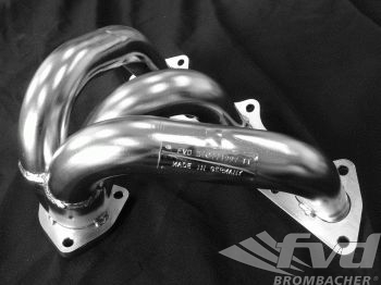

Originally Posted by Rhonda@FVD
All FVD headers are mandrel bent with a pyramid style merge collector that extends to the flange for smooth, laminar exhaust flow and are manufactured from the highest quality T-316 stainless steel and produce dyno proven horsepower and torque!
Here's a link...http://shop.fvd.de/us/en/Porsche-0/9...aders-set.html
Thank you.
Do you (or anyone) have an idea of why some headers, like FVD, use a single piece for the primary, while others, like AWE, weld together multiple shorter tubes?

Originally Posted by cannga
Thank you.
I don't think it matters if the tubes are mandrel bent or welded as long as the over all length is the same for each and the radius of the tubing is not "cheated." What does matter is that the radii are not cheated...meaning
tubing bend needs to be cut perpendicular to the "tangent" line.
If the tubing is cut at an angle that is not perpendicular to the tangent, the overall radius changes and flow is disrupted. When you piece together pieces, not only do you have to check to make sure the radius is constant, but the joints for the pieces also do not cause a radius change.
Thank you.
<link rel="File-List" href="file:///C:/DOCUME%7E1/sales4/LOCALS%7E1/Temp/msoclip1/01/clip_filelist.xml"><!--[if gte mso 9]><xml> <w:WordDocument> <w:View>Normal</w:View> <w:Zoom>0</w:Zoom> <woNotOptimizeForBrowser/> </w:WordDocument> </xml><![endif]--><style> <!-- /* Font Definitions */ @font-face {font-family:Tahoma; panose-1:2 11 6 4 3 5 4 4 2 4; mso-font-charset:0; mso-generic-font-family:swiss; mso-font-pitch:variable; mso-font-signature:1627421319 -2147483648 8 0 66047 0;} /* Style Definitions */ p.MsoNormal, li.MsoNormal, div.MsoNormal {mso-style-parent:""; margin:0in; margin-bottom:.0001pt; mso-pagination:widow-orphan; font-size:12.0pt; font-family:"Times New Roman"; mso-fareast-font-family:"Times New Roman";} p.MsoBodyText, li.MsoBodyText, div.MsoBodyText {margin:0in; margin-bottom:.0001pt; mso-pagination:widow-orphan; font-size:10.0pt; font-family:Arial; mso-fareast-font-family:"Times New Roman";} a:link, span.MsoHyperlink {color:blue; text-decoration:underline; text-underline:single;} a:visited, span.MsoHyperlinkFollowed {colorurple; text-decoration:underline; text-underline:single;} @page Section1 {size:8.5in 11.0in; margin:1.0in 1.25in 1.0in 1.25in; mso-header-margin:.5in; mso-footer-margin:.5in; mso-paper-source:0;} div.Section1 {page:Section1;} /* List Definitions */ @list l0 {mso-list-id:394355404; mso-list-type:hybrid; mso-list-template-ids:-1764352436 67698703 67698713 67698715 67698703 67698713 67698715 67698703 67698713 67698715;} @list l0:level1 {mso-level-tab-stop:.5in; mso-level-number-position:left; text-indent:-.25in;} ol {margin-bottom:0in;} ul {margin-bottom:0in;} --> </style> Cannaga,
In reference to our header's, the turbo header's exhaust flow has such a short length of travel that we choose a mandrel bend set up so that the flow travel's as smoothly as possible. Another reason is that we must pass TÜV approval in Germany. The TÜVperforms an extreme exhaust temperature test, in order to assure the consumer that the parts will withstand cracking and splitting. Turbo exhaust components are subjected to test temperatures in excess of 1,400 degree’s Celsius for extended
periods. We have found that a segmented header design will not stand up to this test as well as the mandrel bent design.
American / German aftermarket manufacturing is very, very similar and their are excellent product's made by both countries. To me the only difference is that German tuner's must undergo serious scrutiny to have their product's approved to be sold in Germany. And in my opinion, the benefactor is the consumer....
If you would like to know more about the
TÜV and what we must do in order to sell our products here is a little more info...
http://en.wikipedia.org/wiki/T%C3%9CV
I think this statement from Wikipedia says it all "Most vehicle modifications also need to be approved, from installing tires of a different size to materials used in nuts and bolts. The German safety guidelines are among the strictest in the world, and getting a road permit for custom-built vehicles is said to border on the impossible." Wikipedia..
FVD-Brombacher parts passed these criteria in order to obtain the TÜV stamp of approval:
