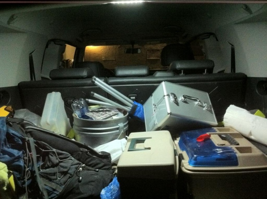

For my FJ Cruiser, I used the LED's from Oznium.com Here's a pic, you can see it lights it up like it's daylight! Best investment dollar for dollar that I've done to it.
