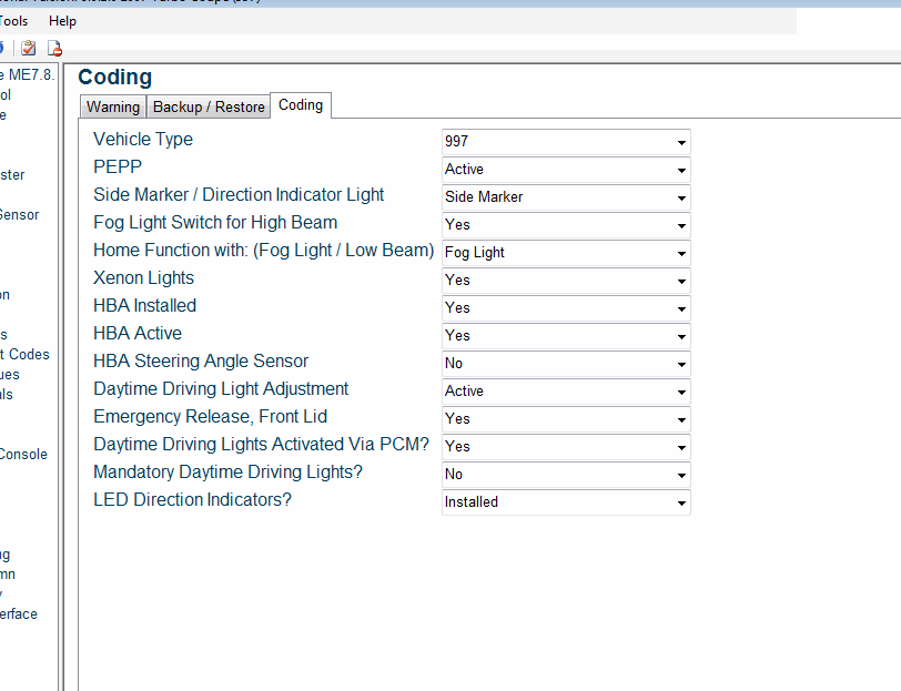

Had a chance to play with my new 6.0B Durametric software...the side marker light can be made to flash like a turn signal...
http://www.youtube.com/watch?v=56jgO-bkkqI
The software will probably allow us to activated LED turn signals for rear bumper conversions once the new control unit is installed.

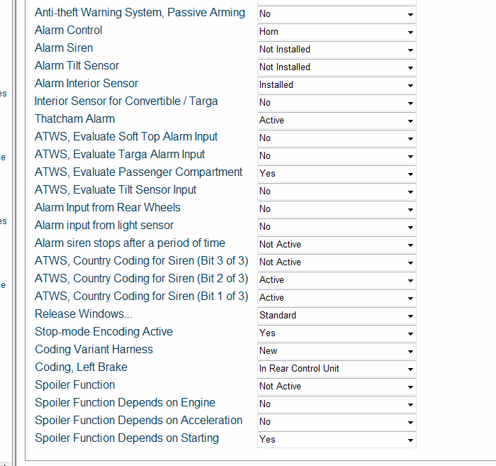

I had the chance to use Durametrics new 6.0Beta software. As many of you know, Durametric has a interface cable that allows access to your vehicles via the OBD2 port. Until now, the interface was limited to data logging, CEL evaluations, and pre-purchase DME scans. 6.0B now allows many functions that were previously limited to PIWIS.
As a teaser, here are a few screen shots. As you can see, if you elect to change seats, you can eliminate the airbag warning light completely by deleting the side airbag module. And for those of us who want rear tail LEDs, once the new module is plugged in, we should be able to activate them by accessing the rear module. Likewise those who want to switch to a fixed rear spoiler do not need a cable or wiring hack to shut off the wing...you can either disable it, or leave it fixed, or program it to stay deployed.

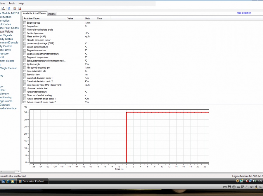

And lastly, we still have very good data logging. IATs to compare stock versus aftermarket intercoolers can be logged during WOT. We will no longer have to guess which manufacturer's design works best. We can track boost pressures and determine if BRVs are effective devices help boost come in stronger.

They have it available at their website...although if you have an older version of their interface cable, you will need a new one...a $150 investment. The beta is still being improved upon. I have no doubt that many of PIWIS's basic features will be available for our use, which is great for those of us who have dealerships that charge an exorbitant fee to reprogram features, or are unwilling to reprogram due to "legal" reasons (ie turn off airbag system.)
