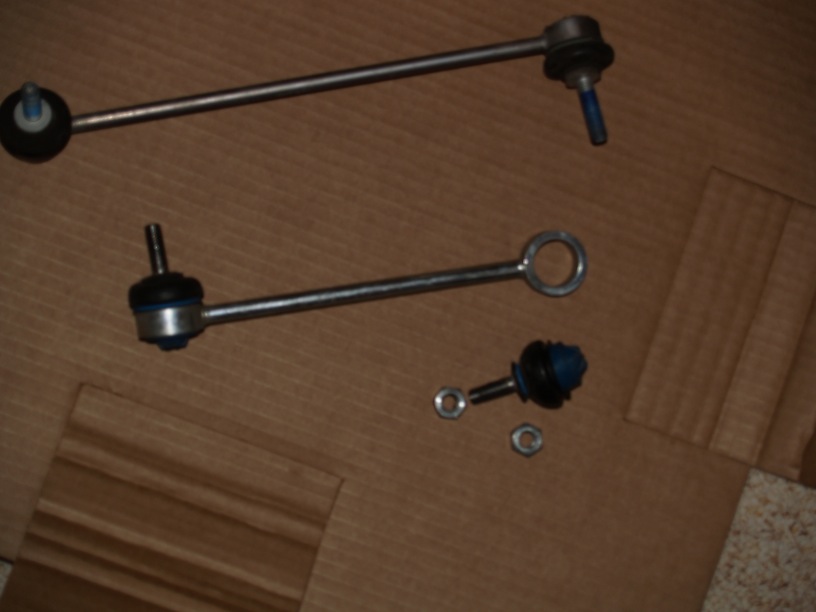

Originally Posted by bbywu
First picture is of Sparkhill's damaged Bilstein drop link, installed incorrectly. Note the direction of the drop link bolt on the damper. It is inserted on the shock from behind. The lower end is inboard of the sway.
Second picture is of Sparkhill's new RSS link. Note the direction of the drop link bolt on the shock...it is again from the rear. And now, the lower end is outboard of the sway.
Does this look correct? I thought the bolt was suppposed to be from the front on the top, and inboard on the sway?
The reason I ask, is because the third photo shows a TechArt/Bilstein setup with the drop link on the inboard of the sway, but the drop link bolts on the damper from behind (a third variation.)
Some of the experts can chime in, but I am pretty sure the Bilstein drop links were installed correctly. Here are the install instructions from Bilstein - the photo orientation is different from mine, so it makes the orientation a bit difficult for me to sort out.
Originally Posted by cannga
sparkhill,
The SharkLink does not look like the rod end type (Heim joint) that's all metallic; it looks like the plastic bushing similar to that of the stock drop link?
If so, are you using the same type -- plastic bushing -- front AND rear?
Reason I asked: Because the metallic Heim joint increases the effect of sway bar (both how strong and how fast -- there is no "give"), may not be a good idea to mix them?
Cannaga: as always, excellent points. I am stock in the rear.
As to Mikelly's perspective, also great points. I am 97% street and 3% track and was continually needing to have the adjustable front drop links adjusted. I do not have a lift and the frequent adjustments were inconvenient and costly. I am happy with my modified "stock" drop links. They don't require adjustment (both a positive and negative) and they are sturdier than the crap Bilstein provided. If I shift to more track time, then I will probably go with the Tarret's or something similar. I feel that I am far improved from stock now, I drive mostly on the street, and my driving skills are still pretty raw so I can afford a little compromise at the moment.
I am still learning and threads like this are great!
The reason I ask, is because the third photo shows a TechArt/Bilstein setup with the drop link on the inboard of the sway, but the drop link bolts on the damper from behind...kind of like the way the Bilstein drop link was installed incorrectly.
Bob, my Bilsteins are attached from the rear and outboard of the sways. I believe ECLOU's are also installed in this fashion. I have 4500 miles on it and Gene has almost 2 years, no issues.
only on the 996TT would have the drop links installed on the front of the shock(towards the front of the car).
I have mine(RSS) installed on the rear of the shocks and on the outside of the sway. No issues and no noise. I have posted some pics of mine in this thread.

I was under the impression that the Bilstein drop links installed from the rear would increase the torque motion, causing them to fail prematurely. Since I am installing beefier ones, was curious if it made a difference, provided that the angle is not to extreme.
Many thanks to all that gave input...links are on the way.

Originally Posted by TT Gasman
What's the downside to using a heavier duty drop link with metal heim joints on the street? Has anyone considered ride height as an issue with the drop links?. Does anyone know the relative lengths of the drop links, stock/Bilstein/GT2?
Valid questions. I have changed from plastic bushing to metallic heim joint drop links twice now, the second time purely to confirm & learn the difference and give a "comprehensive" report.
In my experience, there is no doubt that the metallic heim joint have pluses and minuses. Just like any other mods that we do.
First the pluses: Obviously, a solid link will increase the effect of the sway bar (think of pushing an object with a rubber stick, then replace it with a metal stick). In addition or perhaps as a result, the car feels more planted, and there is less rubbery/bouncy feeling, seemingly less vertical motion.
Minuses:
Noise: Don't ask me why, but there is no question that in my car the solid link brings more tire noise AND engine noise AND road noise into the cabin. I have noticed this both times that I switched in and out.
One example, when you go over the road reflector, the solid link gives a loud crack, the rubber link gives a low frequency thump.
There are freeway crack that I would avoid with the solid link and not with the rubber link.
Ride: No question also that the solid link makes the car feels stiffer. We had a discussion about this in that long rennteam thread of mine on the Bilstein. A guy there ("GT") and I were talking about how intolerable the ride is with the solid link in the stiff setting. We were surprised because no one has mentioned this... well, no one that we know has ever reviewed a drop link anyway. But bottom line: YES, it affects ride.
Your concern about the longevity and durability of all solid metal links are also valid, although I've rarely seen reports of these failing. For sure the exposed joints bring concerns, and I am waiting for more users' reports once we have more people using this.
Tarett might be working on a rubber boost system to cover the exposed metal link and keep it lubricated.
Here's stock 997TT versus Bilstein. GT2 links are shorter than the Bilstein's based on the mounting location on the stock damper.
Very easy DIY if you have ramps.

I am beginning to think more and more that the weakness is in the Bilstein's version of the plastic bushing. Why? The stock plastic bushing doesn't seem to have the same problem, and neither does sparkhill's "Sharklink" below.
So if and when my Bilstein link pops out, if I don't want to go to Heim joint type, then the best solution might be the Sharklink!
sparkhill, do you know what exactly is it that Alex is using on your car? Is it a stock GT3 drop link? TIA
I am pretty sure the SharkLink started as a stock part that was cut, reoriented, shortened and re-welded but you really would need to talk to Alex. It has been on my car about a week and I am happy with the performance. The ride seems similar to the Bilstein drop links except the sway bar is actually connected. It seems like a good compromise for me at this time.

Originally Posted by TT Surgeon
Talked to my man at farnbacher-loles, they are installing my B16s next week with the bilstein links. They prefer the bilsteins over most of the atermarket items available, according to him it's all in the install and not going too low in the ride ht, they've installed over a 100 sets with zero link failures. This is the guy who sets up the 87 car, so I think he knows what he's doing.
Chris, can you post a pic of what your drop link looks like before it gets installed? I would just like to see what the new version looks like. My understanding from Bilstein is there has been 3 revisions of their link for the Damptronic system.

Operation drop link...done
Drop links are in...very easy install, basic tools.
And the verdict is...well...we'll have to wait for another trip to Road America...and it's already November in Wisconsin. Oh well. Daily driving...no real difference, maybe a tad sharper in my turn in, road feel is the same. Well...if you have to replace the twigs from Bilstein, it's an easy straight shot.
BTW, anyone have torque settings for the bolts on the dampers and sways?
