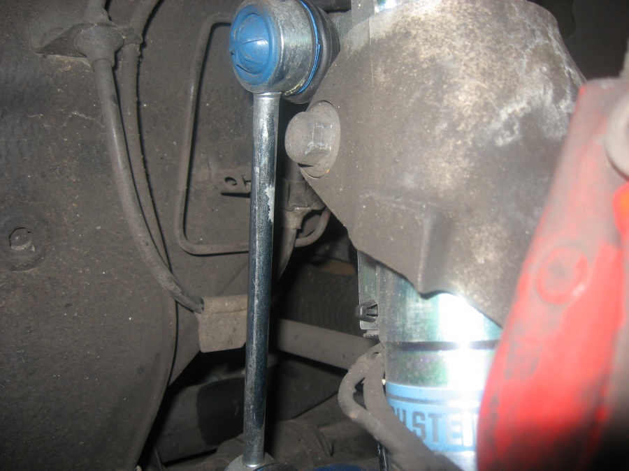

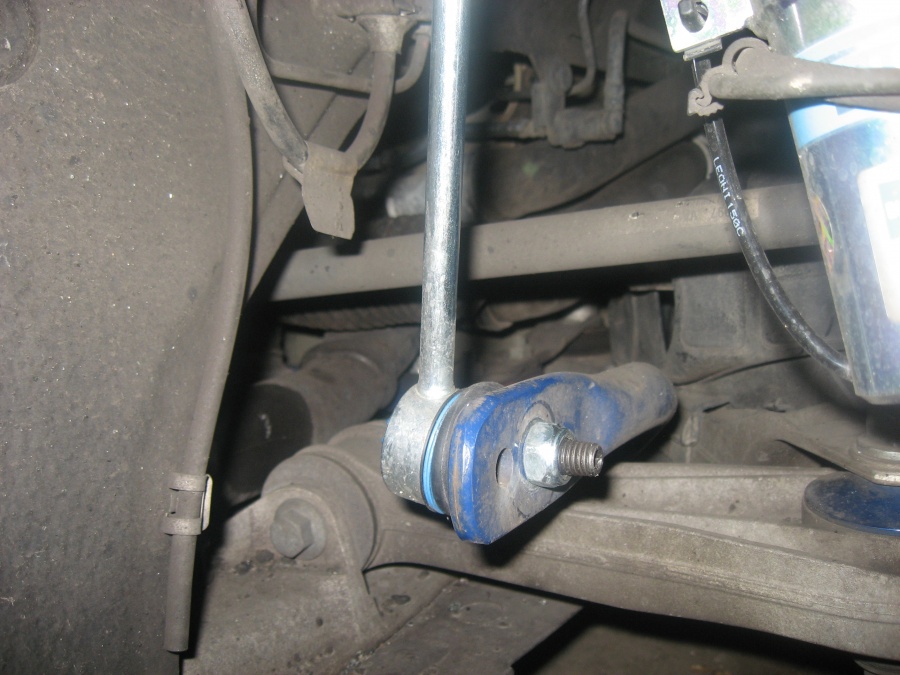

Here's a shot of my FL installed droplinks Itook while mounting my snows last nite. My ride ht is at -15mm.

Chris...I know FL told you that those drop links will be okay...but I'd just keep an eye on them. They are the same design as the ones that popped out on me.

They actually look a lot like the one I snapped on my PSS9 setup a couple years ago...

Chris,
Those look just like the Bilstein B16 drop links. Are they different?

They are supposedly the latest(3rd) version from bilstein.
Bobby, so far so good, we'll see at the track this spring.
Thanks for the update. It is kinda funny Bilstein would be on version 3 now when they claimed there were no issues with version 1 or 2. I hope they work though as I think they offer a good compromise for daily driver comfort.
