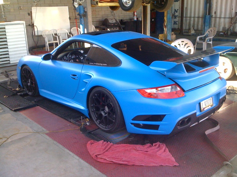

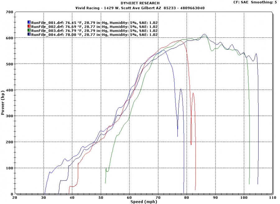

I could be wrong... but everything I have heard and having tried it myself, you cannot dyno the Porsche in AWD mode on a DynoJet. When we tried to dyno my car, the rollers would not be spinning at the same RPM causing the EXACT same issue you had. My 800HP car made about 550 awkward horsepower on a DynoJet AWD.
Give me 5 mins and I will upload my dyno to show you.

You can blow up your center diff, so NEVER dyno on that again. You have to dyno on a Mustang Dyno or a Dyno Dynamics. The DynoJet usually reads about 50HP higher then a Mustang. When you dyno in rwd you also have more to show without as much drivetrain loss, you can see that on others performance kits.
Here are my dyno sheets using a DynoJet and you can see the issue too. 1 roller was spinning at about 1000rpm off of the other one whether we were in 3rd or 4th gear. The day before this car made 700+ awhp on my Mustang. Here is the result of the Dynojet.
