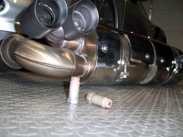

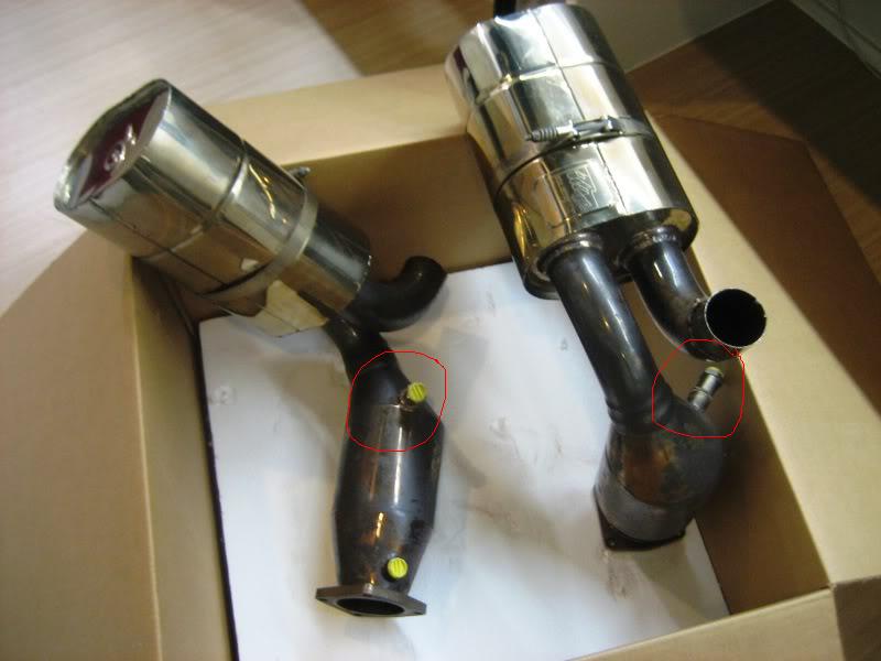

Pictures of the tubi exhaust with the longer "bung" from two different sellers. I believe this comes factory from tubi.

I seem to recall my old Tubi had a short bung on it.

It's definitely a separate piece i've been through several exhausts currently a Fabspeed version 2 & one of them came with these,they are extensions for the sensors needed on some cars i guess ,i'm sure you can get them from any of the exhaust co ,i'd try Fabspeed 1st.BTW thats a Milltek in the pics currently looking to sell it or trade it for a Tubi.

You are correct, the tubi's do come with a bung, now we know why. You can get them from fvd, or even your local parts store where they are marketed as 'spark plug extensions', ~ 20$ pr.
You just need to add a pr of bungs, problem solved.

Yes, someone mention the bung awhile ago however, i didn't know that the bung was a separate piece. I assume that the Tubi built the exhaust with a non removable bung.
