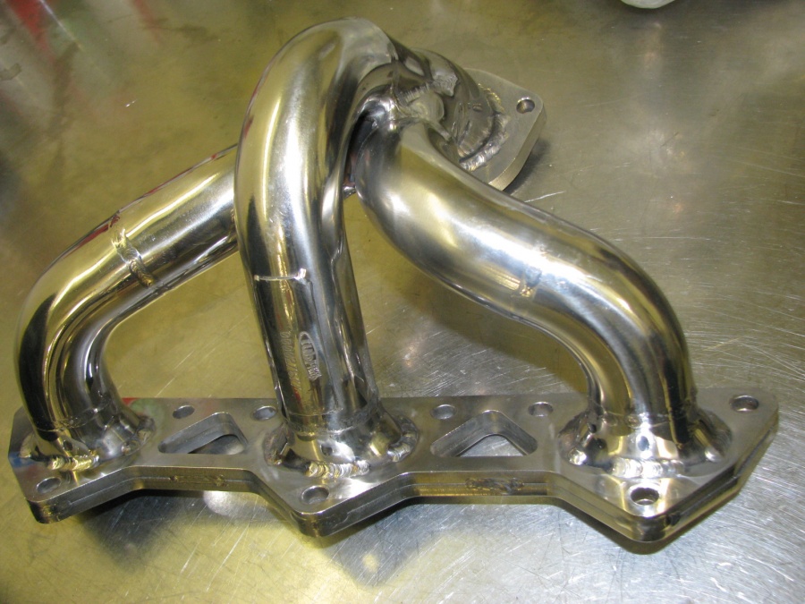

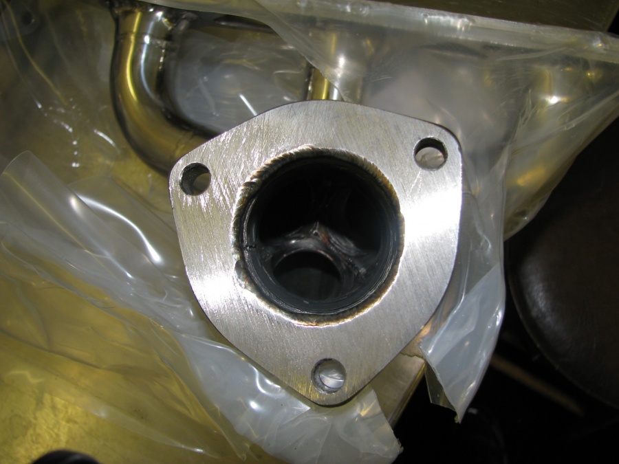

Champion Motorsport offers the Tubi Style 997.1 Twin Turbo headers. Like most of the Porsche-Tubi Style product line, CMS had influence on the design.
Features: 1.5" primary tubes, twin layer flanges, Hand formed fully welded merge collectors with full internal cone, near equal length tubes, full stainless steel construction, and hand polished.
We find that the smaller primary tubes do bring in the torque quicker. I however do agree that it is pretty important to stick with a package developed by a reputable tuner. Random components without a proper tune can produce disappointing results, we have seen it time and time again..
Some photos..
