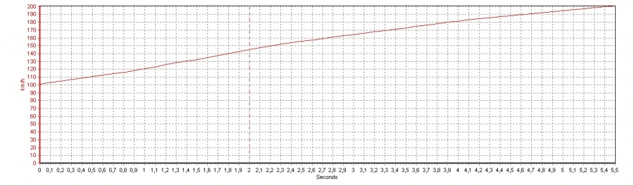

Today i bought a new sd card (i lost it) so to save my runs...oh...today i also installed Remus exhaust...So i have APR flash,Fabspped intake and Remus exhaust...Car is a tip and i made an 60-130miles run that was sent to Scott for verification...from that data,100-200km is obtained...Have a look and try to find a faster 997TT tip with stock turbos and pump fuel...
P.S. slope is 1,7% so its within limit of 3% for verification...

Outstanding performance!

Yes...i couldnt believe it myself...i did 7 pulls,5 of them were 5,8 to 6,0 one was 6,9? and the best was 5,5...maybe the car still adapts to the exhaust...

This time would suggest you are running at least high 500s whp. What octane were you running?

i am running pump gas,super unleaded fuel which is about 95oct of USA...But i can not understand differences from run to run....

Which time was the fastest? First or last run? You may have been heat soaking your engine and intercoolers with each progressive run, which will dramatically drop your time.
Very impressive. What did you run for 60-130? I think the fastest on 93 octane pump I have run is 7.3...fastest on record that I've seen for a manual is 7.1 on 93. I am assuming you are in the 6's, which would be incredibly impressive.

the second one was the slowest while the third one was the fastest...However i just installed exhaust and did the runs...6,48 is my 60-130 time...
