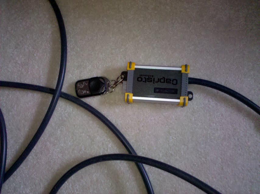

What makes the 997 Turbo system a little more expensive then some of the alternatives is the valving. The system comes with an "ECU" that's used to program the opening and closing of the exhaust valves. So let's say you want it to open at 3000rpm's, or at 50% throttle, or you want to manually open/close the valves....it's all programmable. Install is a little more involved then your average 997TT system. Plan a couple extra hours to wire and program the valve controller.
thanks i hope so ! after reading the ecu control manual , the ecu monitors back pressure constantly and opens/close based on the back pressure programmed , cruise, sport

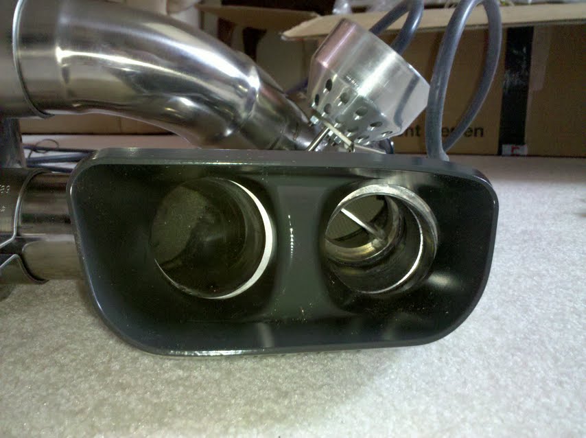

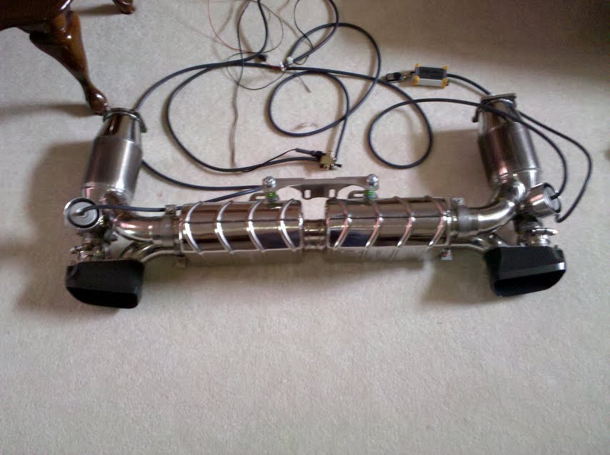

the exhaust arrived today , here are some pics, notice how the flap opens and the muffler is completely by passed, i wonder how thats going to work !!!

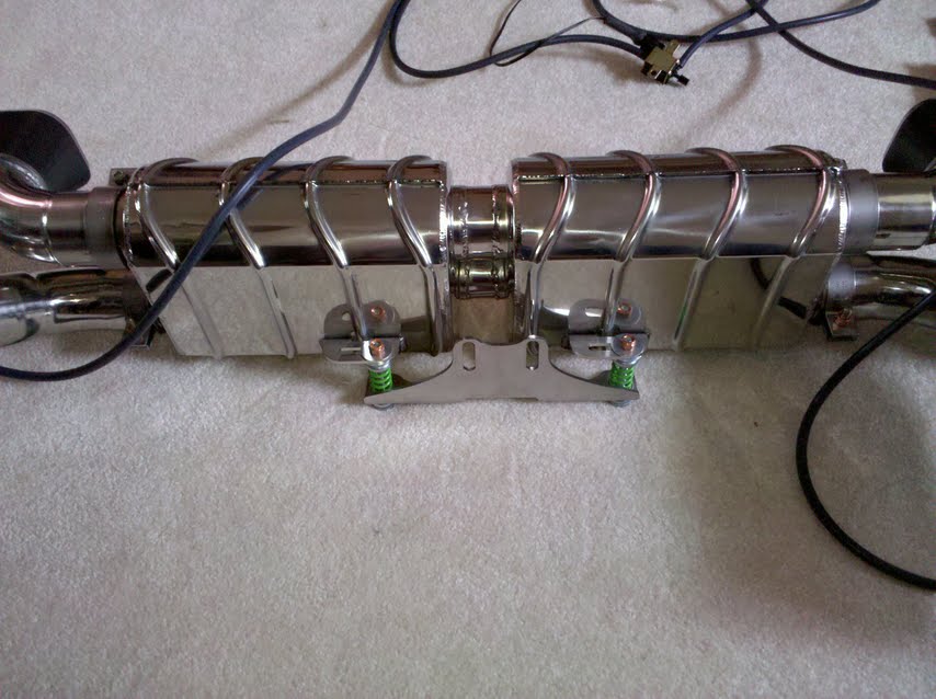

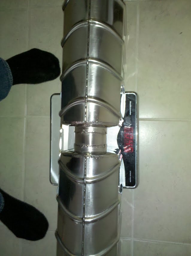

some more pics, it weighs 45 pounds, not sure why the tail pipes are not flushed to the pipes?

Congrats, that looks very well built.

Yep agree those tailpipes look a worry.....and theyre the only bit you see too.

ya took the flanges and the tail pipe apart, it seems like as soon as you tighten the screw, it lifts off on the other side, so i slightly bend the flange and fit ok, there is still a slight gap, not as bad it was before in the pic, the vlaves are used on the other cars so this is not some thing new. will start the install procedure soon

talk to the dealer about the gap ,its there for purpose as the tail pipes are aluminum and the gap sucks in the cold air to cool the tips down, because i told him i was afraid its going to melt my bumper and he said that is normal part of the design, it makes sense now.
