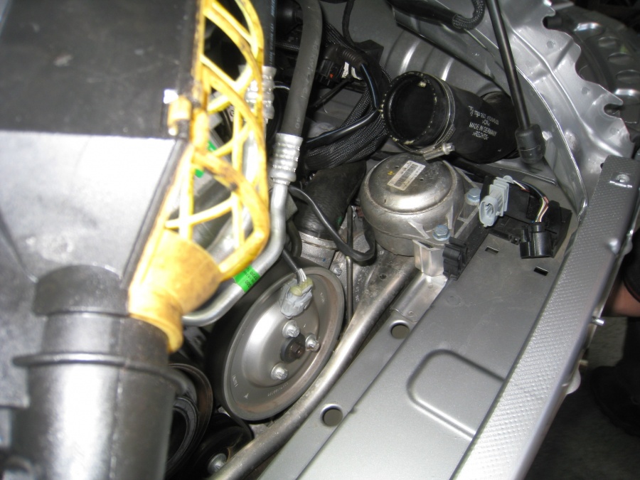

Originally Posted by dma550
Cool, thanks guys. Wow speed, that is tight.
I have one of these ratchets and a set of these wrenches with the socket head extensions - very low profile. That shield does look in the way.
I did a larini exhaust on my lotus and hat to *cut* the heat shielding off with an air nibbler, so I am hoping this is less destructive.[IMG]file:///e:/Temp/moz-screenshot.png[/IMG]
None of those tools will work on the top nuts. No bend at top, too long and, ring of spanner too big in dia. You may be able to use it if you take off the intercoolers. The other ratchet you show next to the ruler. Forget it...that will no way work....way way too big on the head. You need the one in pic 1...nice and slim and short handle. You simply dont have the room up there.
BTW, Speed21, *thank you* for the pics. I don't know if I called you out, but ++rep!
Thanks and glad to help. It's a be a bear of a job if you are doing it blind first time. I have pics on every step so if you need clarification on any step let me know. Remember the 02 sensors will require the y pipe and air box removal so do that first before tackling any removal of the stock system. The wires clip in too far on the inside of the engine bay to be able to be unclipped and re clipp them into their holder fittings. Its fiddly.

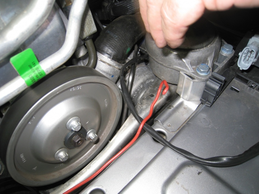

Originally Posted by cgng30
thanks for the advise, yes i have ordered all new gasket, studs and bolts. i am little concerned about the o2 sensor wires, how can one damage then unless you cut um or some thing, i know i pulled the wire of the clips in engine bay , they have a plastic protection on it. so i hope i did not damage the wires,
Its whats inside the plastic that youve really got to be very careful with. These things are delicate and really should not be pulled or twisted up in knots. You may be lucky i hope....lets hope so for your sake.
With the bendy spanner, the boomerang shaped one isnt the best and still makes for hard work but see if you can get the right one....you will thankyourself you did.
The car should look like this:- See Pic... and if the boomerang bendy you are waiting on winds up still too hard for you on the top left one then take off the intercoolers and the also side heatsheiding. Bending these up out of the way isnt the best, or having the spanners bang into it will leave the shields battered and bruised.

Ask "Neil" how does he unclip the sensor wires from the stays withot pulling the wires and more to the point how on earth does he get them back in to the stays (the clips on inside body) without taking Y pipe and airbox out. I'd truly love to know the answer to that one......
ya i would recommend like speed 21 to take the cable with the exhaust, there are f clip total , 2 top , and 2 underneath (each side) , and then you got fish the connector from the top and leave the cables hanging, then remove the exhaust. i am waiting for the half moon spanner, to see if i can get nuts out, they are all loose though. ya i have more work because i have to tap the vacuum and power for the ecu.
The half moon has the clearance to actually go over the top nuts but the limmited travel is the problem. You can only move the spanner a very very small amount each time so it takes forever. I'm pretty sure the half moon still has a major problem with that top left one as the bottom part of the spanner curves into the turbo so you have no leverage and very little to zero movement of the nut. And, once you move the nut and then reposition the spanner again sometimes it wont line up on the nut....tiny increments of travel etc. Thats what i meant by easier to take the I/c's off, as for all the time it takes screwing around persevering with the spanner its eaier to get the access by removing the I/C. See how you go. If you can get the ringy with the bend at the very top then it makes for a much easier and less time consuming job, that i can promise you. If you cant, then you dont have any other option but to either perservere with the half moon on those hard to get to top ones or, remove the LH i/c or, both. It's worse when you have the stud pull out too which will always seems to happen on the worst one for some crazy reason . Its heaven having the right tools .
