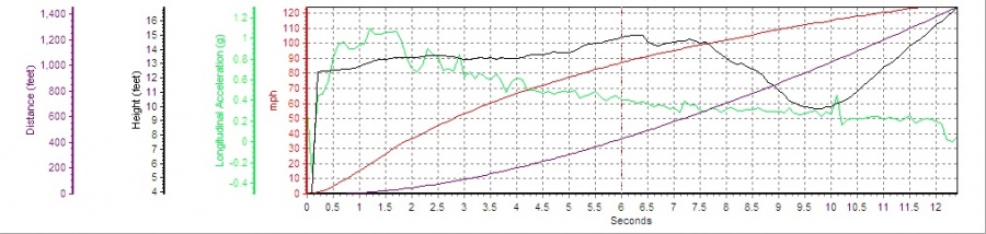

This third runs is in Sport + mode using launch control. PSM remains On.
Simply engage Sport + mode. Left foot brake, right foot to the metal, Launch Control lights up in the steering wheel LCD, side step the brake and hang on for dear life.
Launch Control Run, 0-200:
Launch Control Run, 100-200
The gear changes in this mode are rapid fire. Never felt anything like this in my life. Almost no wheel spin whatsoever, just one huge shove forward.

Figured it out. This is the third run with LC. Here ya go:

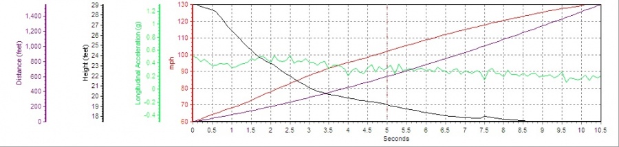

Here are the verified graphs:
60-130 in 10.11 on a 0.7% decline, and...
1/4 mile in 11.47 @ 123.7
Great job, Karim! Those are outstanding numbers for a bone stock car in 113 degree heat!
I look forward to seeing your modded results.
