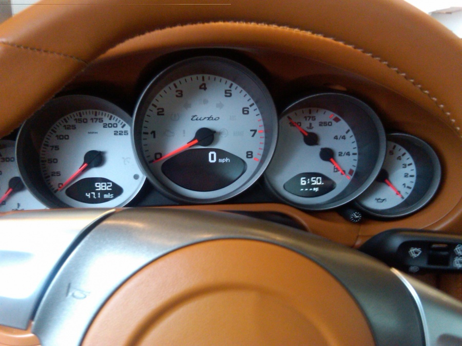

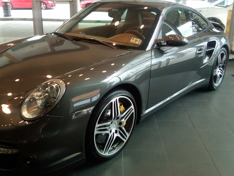

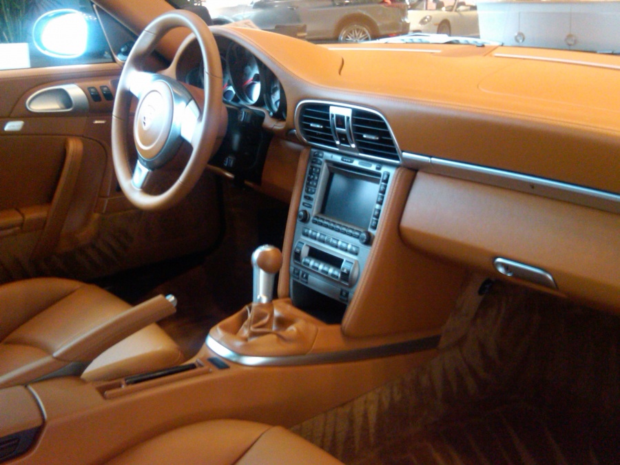

I just purchased 07 TT with 900 miles. It has upgraded brake system. I have an appointment with the Porsche dealer to install the Tubi Regular and GIAC Tuning next Wed. I am also thinking about getting latest Champion Intercooler. My car has the Porsche certified to March 2013. Should I do the Tubi Race Version at this time?
Someone also mentioned on diff. blog ( I was accidently in 997 instead of 997 TT ) that he upgraded his Turbo and change out his clutch and has 700 HP. How expensive is to do the turbo upgrade and clutch replacement? I am not sure if I want to replace that many almost new parts. Car now has 1200 miles on it.
Any advise is welcomed. <!-- google_ad_section_end --><?xml:namespace prefix = o ns = "urn:schemas-microsoft-comfficeffice" /><o></o>
