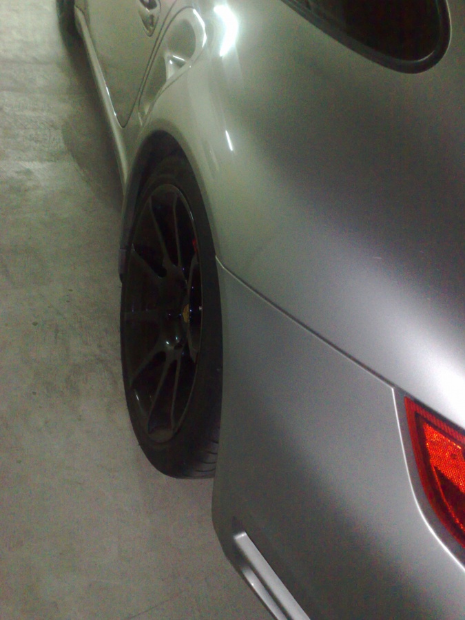

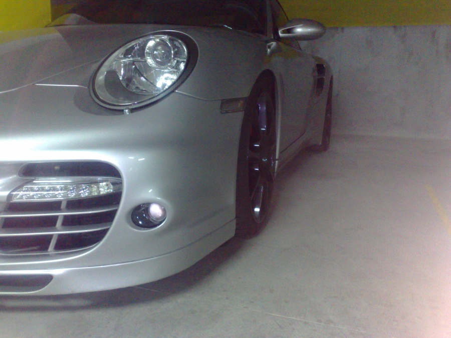

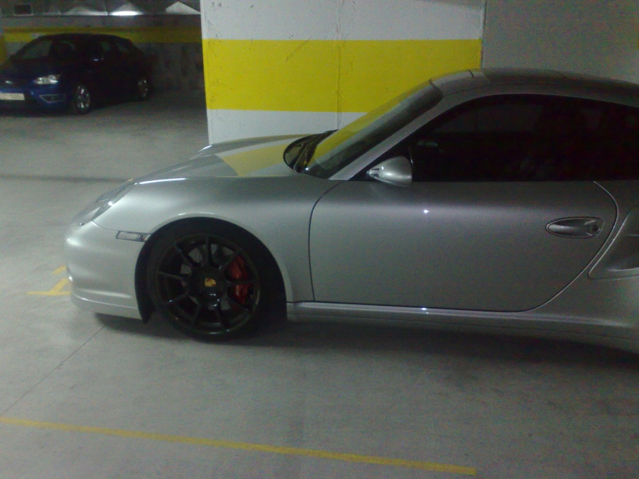

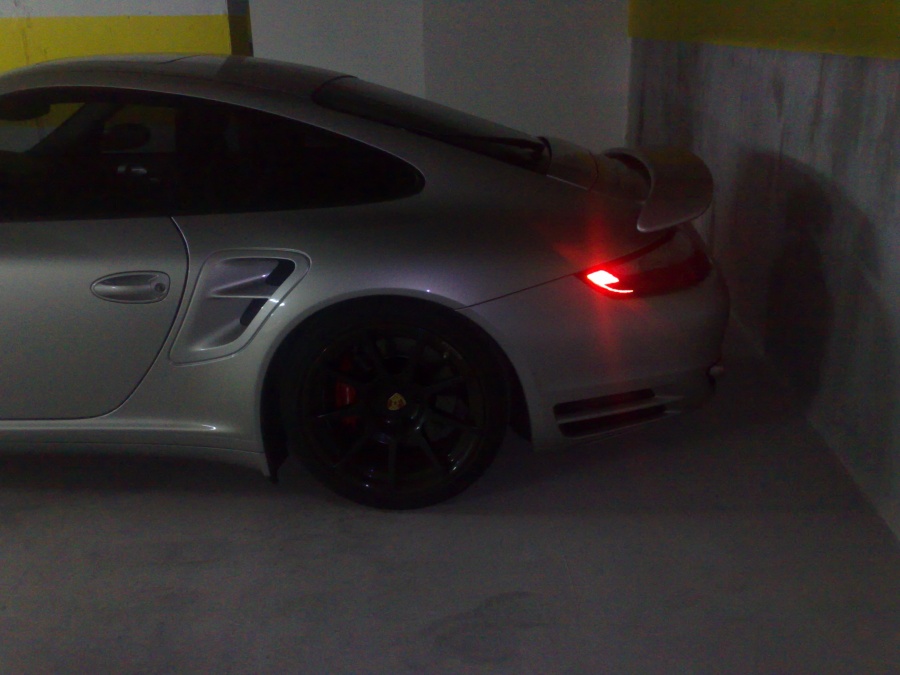

Hello guys...I just wanted to write that HR springs were installed (ordered together with sways but they were for 997NA)...The car feels softer,it is lowered and looks much better and the good thing is that comfort is better now...Turn in is better and i feel that it sticks better to the road...Has anyone allignment specs for lowered 997TT?Are they almost the same as 996Gt2?Or should i find 997Gt2?

I took some (in garage) photos...hopefully next days i will some some outdoor photos...
