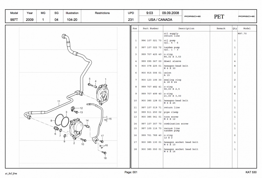

Who can identify this part?
I was under the car trying to figure out where the metallic rattle was coming from on startup (turns out it was my left exhaust tip I think) and I noticed that the item in the picture looks like it has oil leaking out of it.
It is on the driver's side just behind the exhaust.
Can someone tell me what it is and if it needs attention? thanks

Oil and tandem pump.

It looks like your seals are slowly leaking. Part numbers.

It maybe leaking from that torx bolt . Try turn that bolt lose with your hand and see if it's lose.
If it's lose then you will need some sealant like locktite 574 on the thread then torque it back to 7 ft/lb

thanks guys. I'll check the torx bolt. If it's fine would this be something covered by warranty?

Should be a seal and a warranty item.

Surprisingly, the bolt was easily loosened by just my fingers. I retightened it and we'll see what happens. I'll have Porsche look at it in the spring when I get the oil changed.

samilar thing happened to me when I picked up the car earlier this year. I have tightened mine back and it's been dry. If you lose it more, you will see oil coming out. I would wipe the area clean though.
