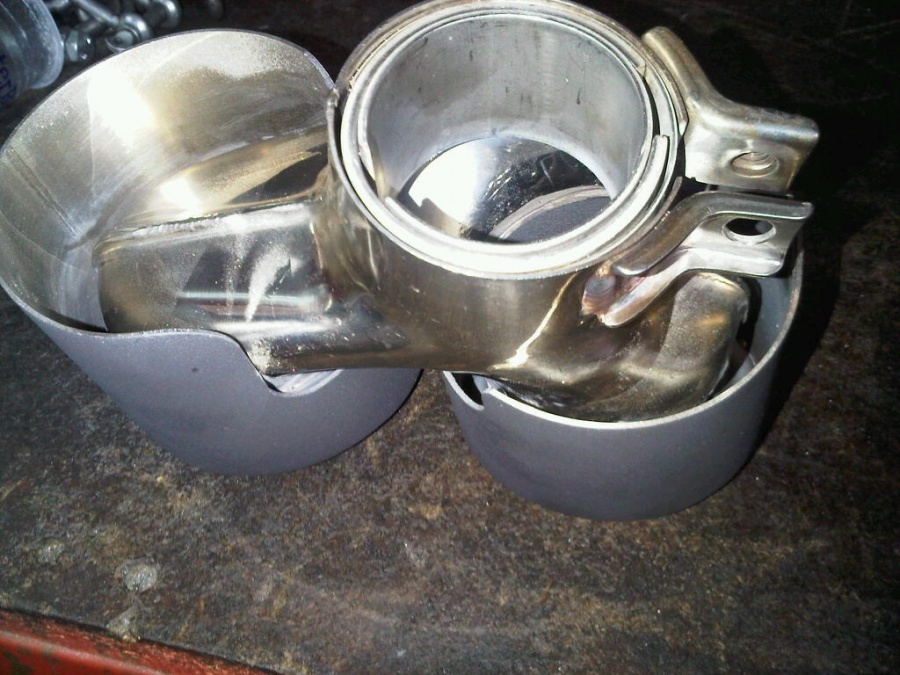

I believe the OP is referring to the turbo, and not the NA car.
If that is the case, then the answer is no... The .2 system is a 65mm pipe while the .1 system is a 60mm pipe (courtesy of the europipe site, thank you Stef)
Having said that, as the .1 is smaller, it is not difficult to get rings to reduce the size of the pipe by .5mm. As you can see from the attached, the tips which I ordered and installed, had such rings, which I removed as they were not necessary. they are rings which act as tightening bits as well, as they are not a full circle but rather have a cut on one side. It should be very easy to fabricate in an exhaust shop...
Why the interest? The aesthetic difference is very small, I do agree the .2 fills the bumper oval a lot better, but the overall difference is barely noticeable I think...

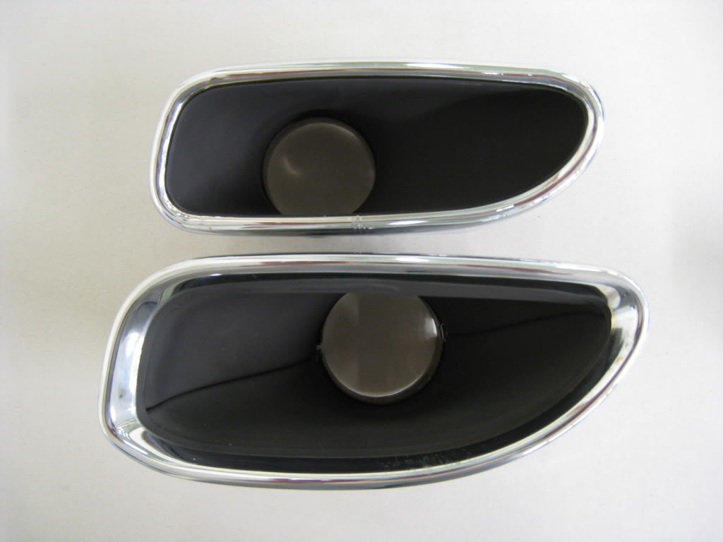

Stef does make bigger tips for the stage 2.
Pic from the europipe website.
The surround remains the same, however the pipe diameter changes.
I think the objective of the OP was to get an overall larger tip.

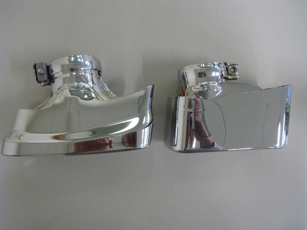

On the 997.1 TT tips the hole is off centre
