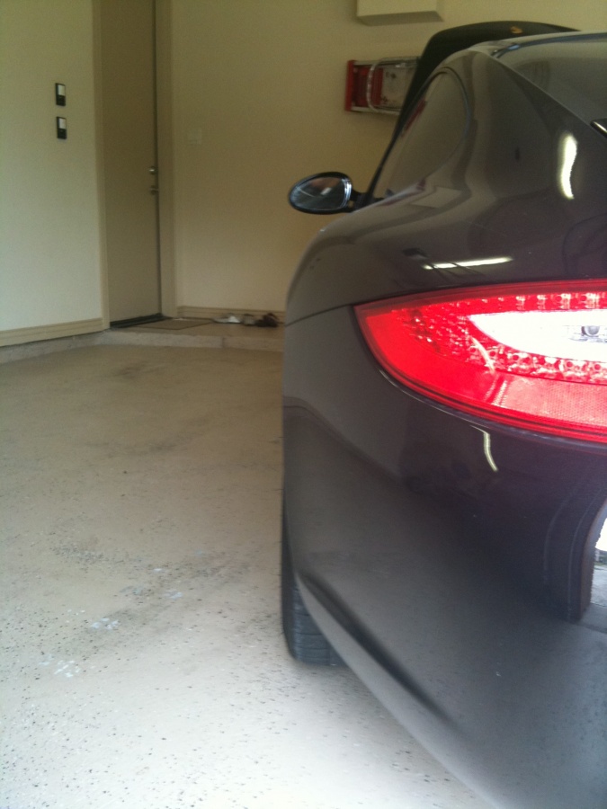

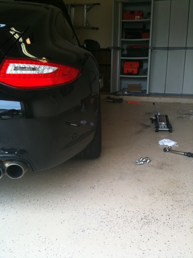

For my 997.2 C2S, I had 7s in the front and 14s in the rear and I thought it was a great look with the 19in Turbo wheels. 5/7 and 14/15 are perfect for the 997 OEM 19in fitments. I don't have any more pics (not have the car anymore - different story there ), but I hope these help:
With Spacer on Rear
Without Spacer on Rear
