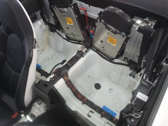

Last week i got my Aquamist HFS3 water/methanol injection kit from EPL and IPD Y-pipe from AwdMotorsports. First of all i want to thank both companies for their great products and service. And a big thank you to Dave and Tony at EPL for their great support, i wouldn't had it installed without them. Thank you guys.
Complete installation took us around 18 hours, have in mind that i used the old AEM fluid tube which is the same in size and matterial. Installing new lines would take another 5-6 hours of work.

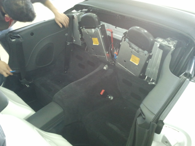

Here are some pictures of installation process

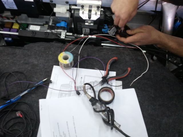

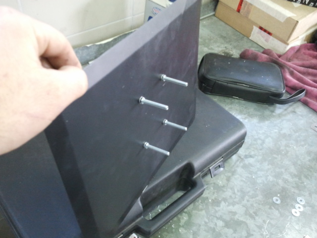

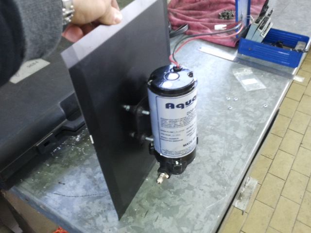

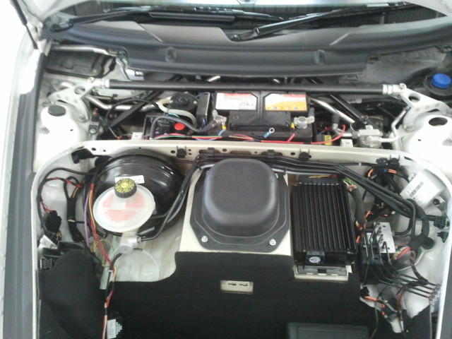

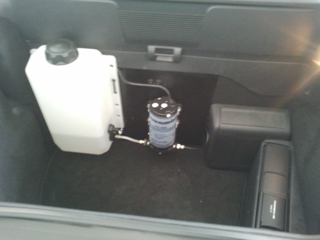

Some more pics of the installation, i made an aluminum bracket where i installed the pump (i copied EPL) The difficult part was to define which ECU cables to connect on the control unit.

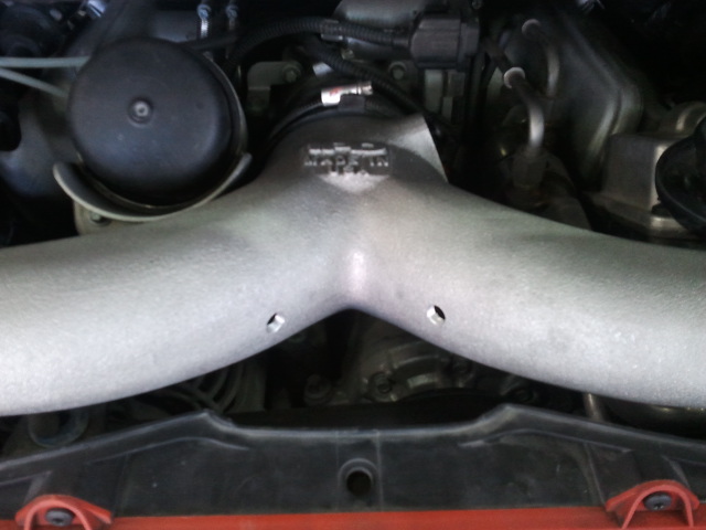

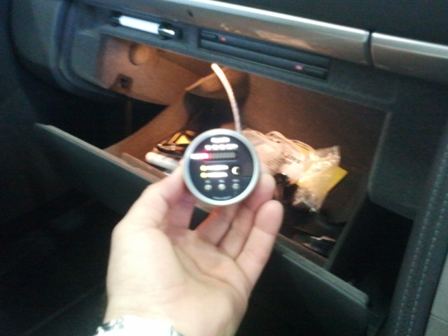

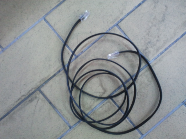

I did a few tests on my stock Y-pipe about where to install the jets, i tried to install them on the bottom side but as Dave said the engine belt would be very close to them. So i finally installed them on the front sides of the IPD Y-pipe. Another importand thing is to make a new gauge cable because it will not be long enough to reach the glovebox.

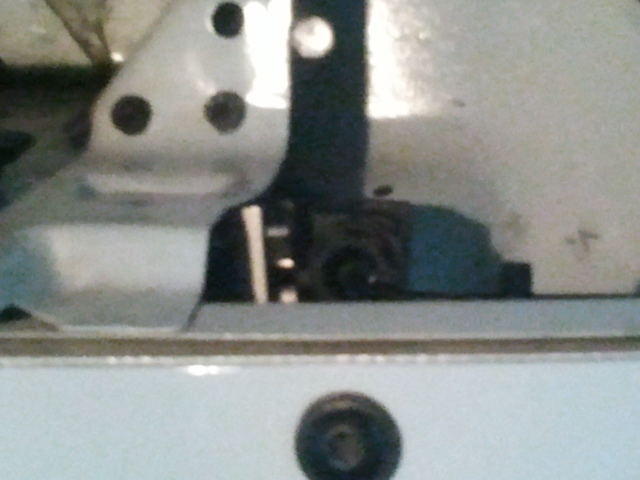

The fast acting valve (FAV) was installed under the bracket where the engine boot locks

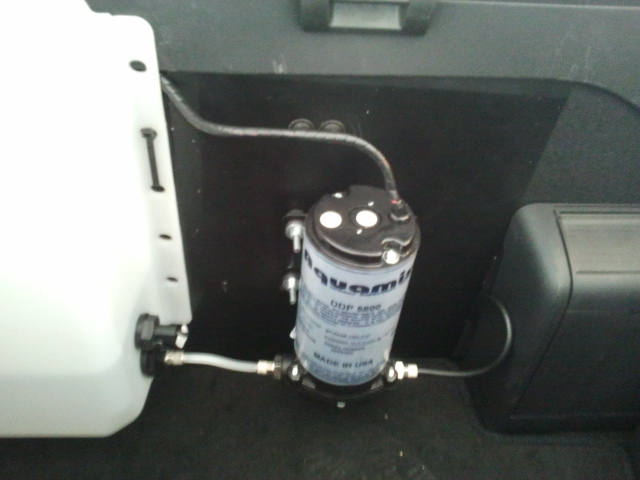

I used both 0,9mm and 1,0mm injectors.
Here is the final look
