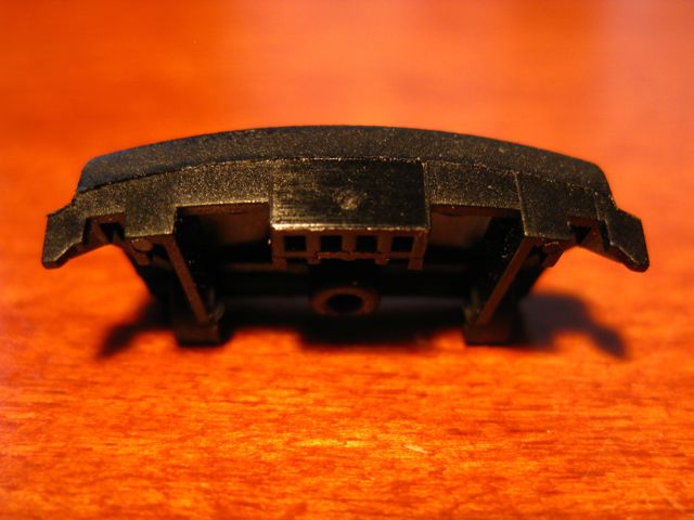

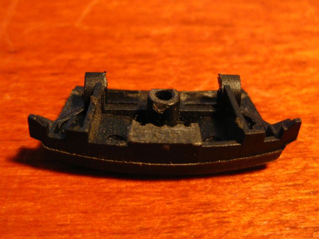

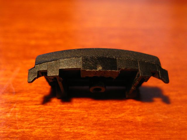

You can save your pennies and do this fix yourself. Each of the fob buttons has a 'pin' that pushes down on the rubber switch membrane between the button and the switch on the electronic board. All is needed is to reduce the hight on the button 'pin' by about 1mm. Just file down the pin. I used my trusty Dremel tool with an abrasive wheel but you can also do this using a small file.Originally Posted by johnww
. . . New tab Porsche#000-043-400-14 ($53) solves problem by requiring the trunk tab to be held much longer than door opening tab. . . .
Total time is about 15 minutes.
Total cost: Free
Take apart your remote key fob and remove one or both buttons. Your unmolested fob button will look like this. Notice the small 'dot' in the center of the pin plastic mould.
Using your Dremel tool with an abrasive wheel file down the pin by 1mm. The distance is about to the edge of the 'dot' visible in the center of the pin,
Another view from the top,
Put the key fob back together and test out. The button will now need to be depressed so that the top of the button surface is slightly bellow the key fob surface.
Problem solved!
