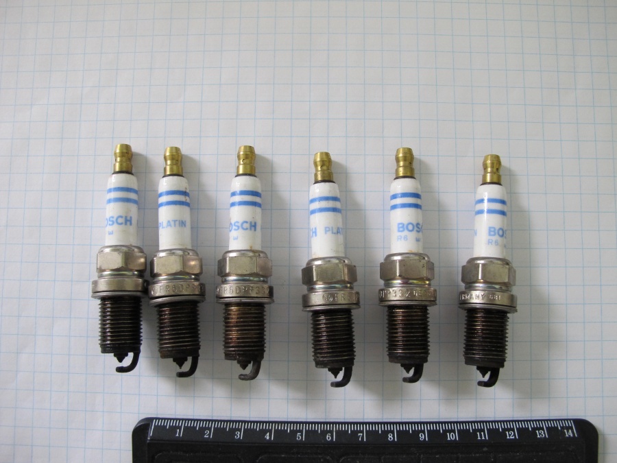

Here's some more info...
Porsche 997 Turbo ECU Tuning and Spark Plug life

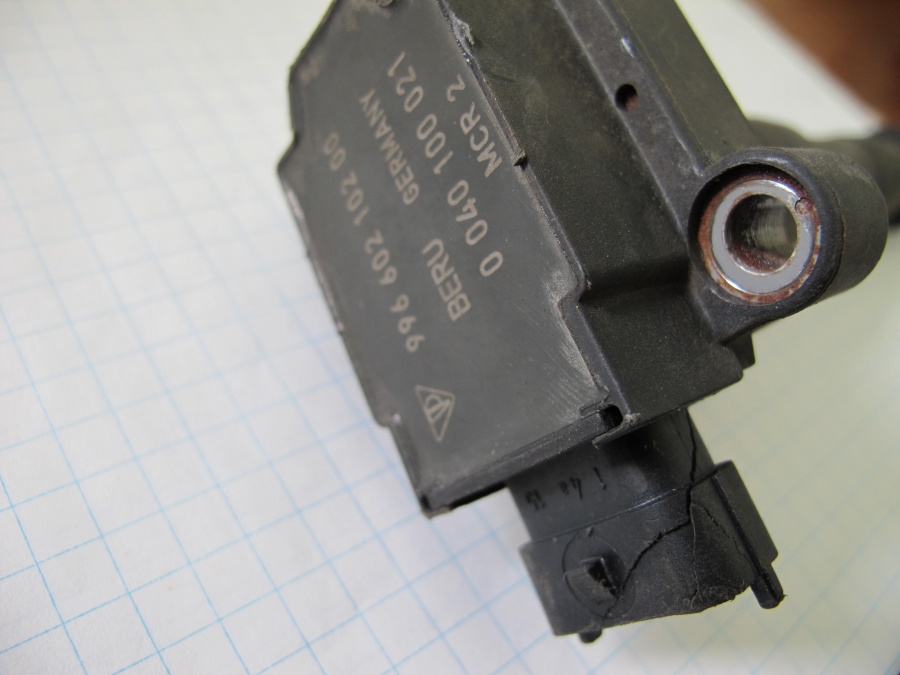

I have to say that my plugs looked similar. My car was pre-owned and turns out that shortly after I got her she started to sputter (misfire in the high RPM range on throttle).
I decided to change out the coils (replaced the OEM 996 that came with the '07 Turbo with 997 ones) and plugs at the same time and went with OEM. After substantial amounts of research, none of the manufacturers could claim that their spark plugs would out last or even out perform the OEM ones. A lot of opinions but no hard facts - none that I could source, or get sent to me. Additionally there's a lot of misinformation out there as to best choices, so I went with the safe OEM bet.
On a tuned car, expect to change out the plugs every 20,000 miles - definitely not 40,000 which Porsche recommends.
