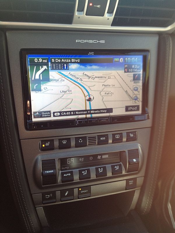

I was thinking about doing a Dension or a Mobridge for bluetooth and iPod interface. Instead, I decided to get rid of the crappy PCM2.1 navigation all together and went with a JVC KW-NT800HDT. This is a 7.1" navigation screen with iPod, Bluetooth, A2DP streaming, etc. This particular unit has an SSD, so startup times are lightning fast (faster than even the iDrive in my 2012 M3). Has a great POI interface, lifetime traffic, etc. Computation time is very good, for changing routes, etc.
So far, the navigation is really good, and the bluetooth quality is fantastic. It is, at least subjectively, at least as good as the factory bluetooth in my M3, which is saying something because the Porsche is a significantly louder car.
I had a couple of quirks, first the JVC doesn't like the speed signal the MOST-HUR puts out (Pioneer decks are compatible, but not the JVC) but I just updated the firmware and disconnected the signal and it works fine. Also, my MOST-HUR was set too loud and I got some alternator noise and white noise but only between songs. I adjusted it, thanks emails from Loi at Eurospeed Motorsports, and it is solved.
I did the install myself, with the Eurospeed Motorsports kit and I was totally thrilled, very easy install. Definitely time consuming but fun. I ended up spending $800 for the install kit and $800 for the deck off Amazon. Ended up spending a little more than the options that integrate with the factory head unit, but ended up with a *much* nicer navigation system. Also, album art and full integration with my iPhone should I so desire, rather than a crappy interface shoehorned into the CD changer controls.

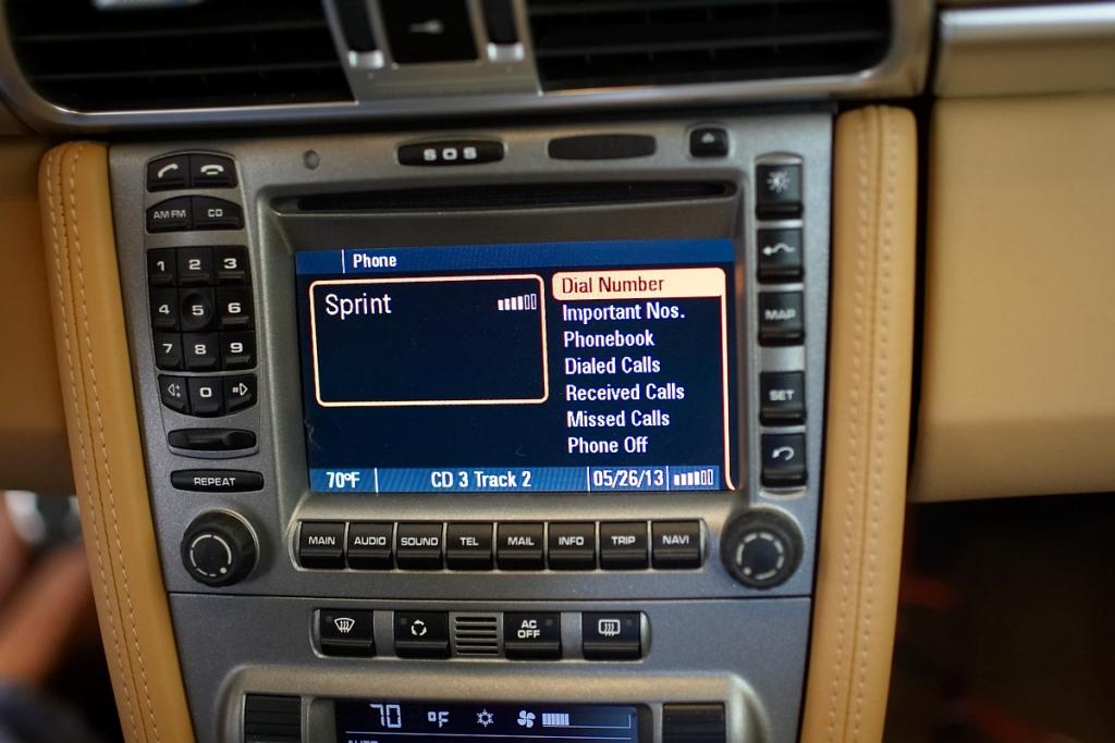

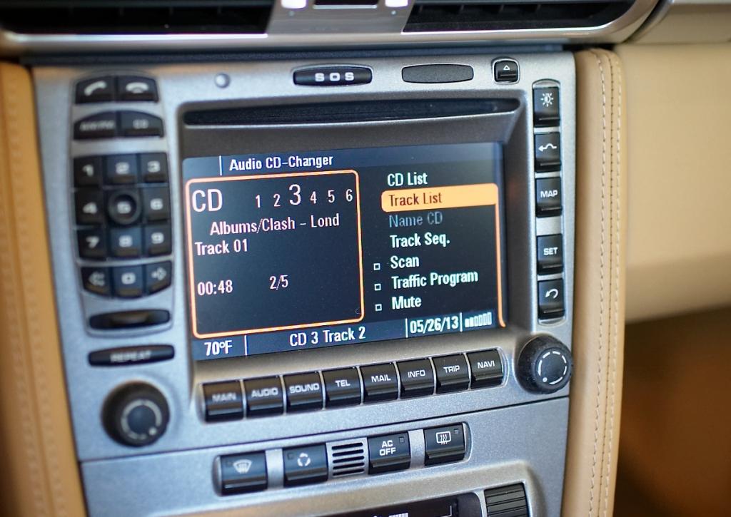

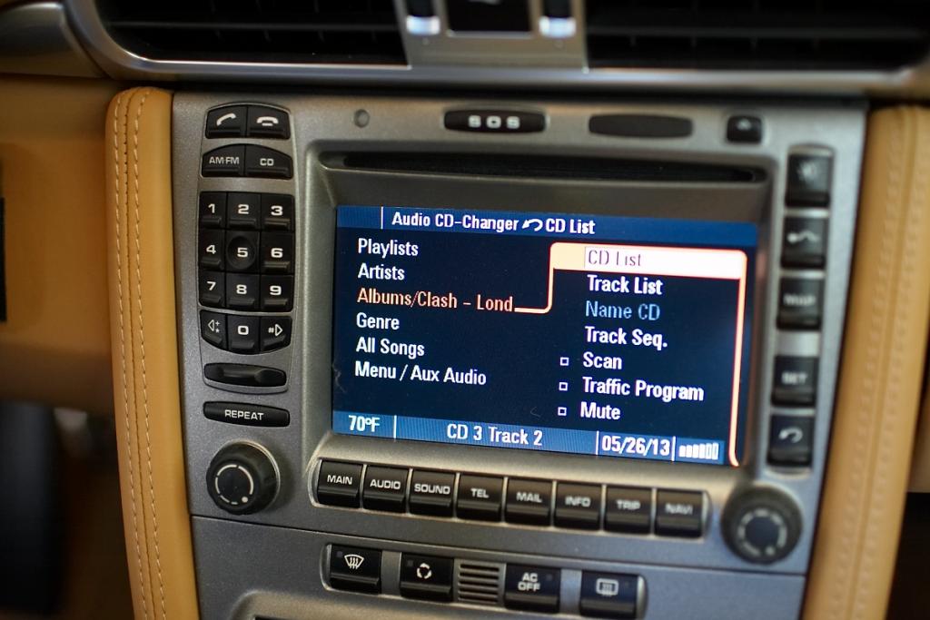

Not that anyone may care since I seem to be the only one on the forum with this MoBridge system , but I have some screen shots, might as well post.
Below is screen displaying "London Calling," first screen shows how you could play througth Playlist, or Album, or Artist, etc. Third shot shows phone number, which has continued to function flawlessly with OEM like voice quality, with both Samsung Epic 4G and Samsung Galaxy SIII.
Once every few months I still get an error message about not being able to find CD Changer, but extremely rarely so and error message easily clicked away.
