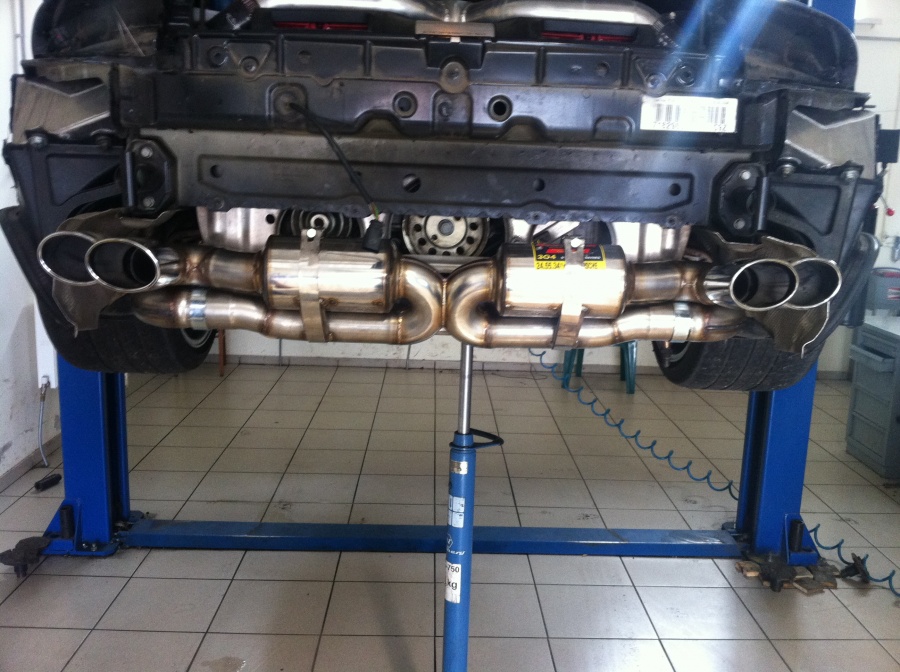

I want get max power from my car,now I have Switzer R750,but with proto tune,! I have install new exhaust at morning,very light and good sound! Next step for my car i think this is plenum and GT3 TB and fender intake,after finish,i think this is max mods for vtg turbos
Old Aug 24, 2011 | 10:12 AM
A448PO's Avatar
Joined: Nov 2008
Posts: 118
From: Russia Rostov-on-Don
A448PO is infamous around these parts
This is foto of supersprint exhaust
