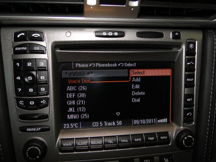

I have a 2007 997 Turbo which had a Dension Gateway 500 installed in it. I purchased the BTA1500 module for it and installed it myself and everything is working except I can not get the iPhone's VoiceCommand to work?
It might be the case that voice command is not possible with the BTA1500, I just want to know if anyone has been able to make it work? My plan was to using the BT audio streaming and use voice command to change playlists, call people, etc
Currently everything else is working, A2DP and AVRCP are working, phonebook transfer and traversing is working, I just can't get the voice command to work.
The Dension/PCM phonebook auto-imports a number called VOICEDIAL, that actually dials *#voice#* but that does NOT work for the iPhone.
Does anyone have this working?

I was just wondering if I was maybe missing some step, for example, to traverse the phonebook with the Dension you have to select a section in the phonebook list, lets say ABC, and then you have to hit the actual 'phone button' to open the ABC list to get a new list of people inside the range of A-C. Its not terribly clear, but through some trail and error, I figured it out ... I guess I was hoping there was some "similar" trick to voice command.
(an example of the phonebook list, ABC, DEF, is in the picture of the original post), not a very "clear" system to employ.

FYI: I actually got a confirm email from Dension today saying the Gateway500+BTA1500 does not support voice dial on the iPhone 4, we will add it to our current line of products and if we have spare cycles will add it to older products like the Gateway500.
I take the last part as a polite way of saying "you are never going to get it"

I ended up implementing a solution with the help of another developer. Its not ideal, but it gets the job done. You would require a jailbroken iPhone to do it though. Basically its a background service that watches for what number you dialed and if it matches a particular sequence (in this case #*voice*#) then it will launch voice command automatically. So on the dension/pcm I have this VoiceCmd number and when I dial it, the number will fail and the voice command will start.
I have a video of me testing it out, if you want it, PM me. Its a little complicated to setup so you should be very familiar with words like jailbreak, ssh, putty, launchdaemon, else, ahhh don't bother.

The Dension is not a Porsche compliant unit, so the voice command will not work. It is sort of "cheating" the system with a CDC/bluetooth piggyback.

The iPhone does not respond to typical buttons for voice control. It will work, but you have to press the home button.

The fact that the workaround was a jailbroken phone should tell you ITS THE PHONE not the system.
