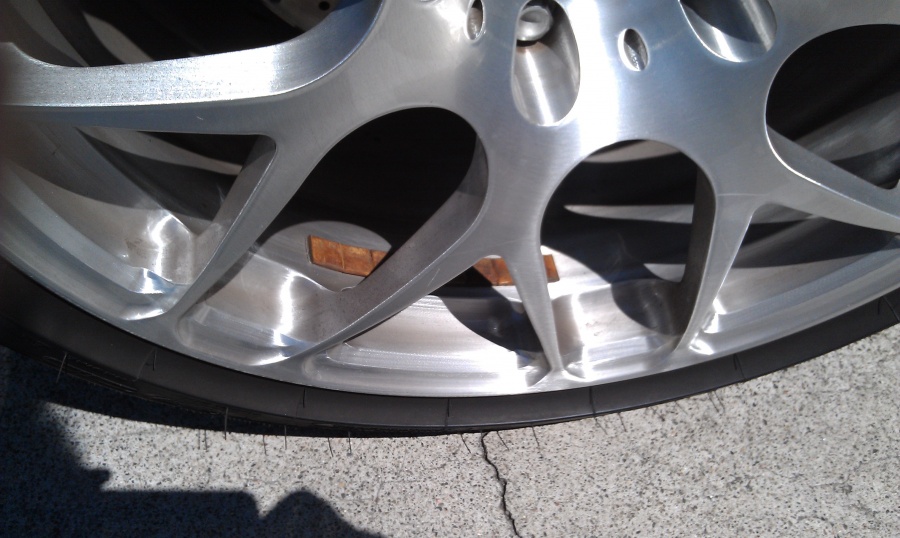

Here in sunny California, we are no longer allowed to have lead tire weights. I think they are worried that the seagulls at the beach will....
1. Be attracted to my beautiful HRE p40's
2. When they are unsuccessful at eating the aluminum rims, they will go for the softer lead weights
3. Then they will develop acute lead poisoning from the weights, they will go mad
4. Then they will attack innocent children and mothers............
So, in attempt to prevent this cataclysmic event, they now use iron tire weights.
When I picked up my turbo (3/11), i kept my HRE p40's and had the dealer put the new tires on my existing p40's. The weights are iron and are rusted. The wheels look like S**t!!!!
Any suggestions (i.e. naval jelly rust remover followed by a sealant)???

We use the steel ones now as well. Not only do they rust, but more of them are needed to get the same amount of weight. Not ideal, but it's the way regulation is heading. Chrome cleaner will take it right off.

Dang that's hideous, especially on those nice looking wheels. Who installed them? They make coated weights.

Well, if people stopped eating those weights the government wouldn't have to step in..... How freaking annoying. That would drive me nuts and those wheels look way too nice for this. They do make coated weights and I use them. Give the HRE-Guy a call, he definitely has the solution.

I would take the old ones off, replace with new plain lead weights or porsche factory plastic coated weights, just replace with all the same weights and center to the old position.

id see how much weight is on each wheel and like others said get new coated ones.
or see if you can get some of these from your local tire guy. cut to size.

I was able to put a little Navel Jelly rust remover to clean them, then resealed them with a clear marine varnish. Worked so so..... The weights were a little darker looking but I could live with the look. <O</O
