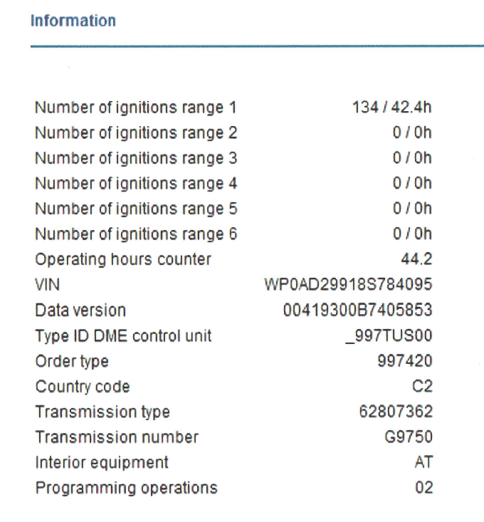

I am no expert but here is my read out. Nothing beyond stage 1 and then only a slight blip. I bought this car about two months ago. A 2008TT with 1075 miles.
Attachment 161161
A 2008 with 1000 miles? What a find my friend. You got a brand new car with a perfect DME report. Good job. I hope you are enjoying your car.
Thank you. I started with a Cayman S, then a 911 S Cab and now the turbo. This was a local car and I was fortunate to find it as you say. It handles like a dream.
Congratulations - great purchase - it looks like the last overrev occurred about 45 miles ago at hour 42.4 - you testing it out?
You got me
Wow what a find - essentially a new car. You are very lucky and congratulations!!
