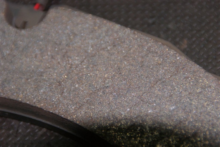

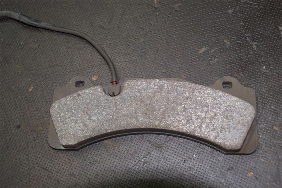

and no brakes after 3 hard braking too???
btw what is the speed limit in the U.S????
here are the pictures of cracked pads:
Old Nov 29, 2011 | 10:12 AM
  #57
997 GT3 RS/TT's Avatar
Joined: Jun 2008
Posts: 1,041
From: Warsaw
Rep Power: 92
997 GT3 RS/TT has a reputation beyond repute997 GT3 RS/TT has a reputation beyond repute997 GT3 RS/TT has a reputation beyond repute997 GT3 RS/TT has a reputation beyond repute997 GT3 RS/TT has a reputation beyond repute997 GT3 RS/TT has a reputation beyond repute997 GT3 RS/TT has a reputation beyond repute997 GT3 RS/TT has a reputation beyond repute997 GT3 RS/TT has a reputation beyond repute997 GT3 RS/TT has a reputation beyond repute997 GT3 RS/TT has a reputation beyond repute
one more, you can see how deep cracks are.
Old Nov 29, 2011 | 12:46 PM
  #58
flavorPacket's Avatar
Joined: Sep 2006
Posts: 410
From: Hermosa Beach, CA
Rep Power: 56
flavorPacket has a reputation beyond reputeflavorPacket has a reputation beyond reputeflavorPacket has a reputation beyond reputeflavorPacket has a reputation beyond reputeflavorPacket has a reputation beyond reputeflavorPacket has a reputation beyond reputeflavorPacket has a reputation beyond reputeflavorPacket has a reputation beyond reputeflavorPacket has a reputation beyond reputeflavorPacket has a reputation beyond reputeflavorPacket has a reputation beyond repute
Yes.
Speed limits in the US vary by the region, they are anywhere from 90-130 km/h
