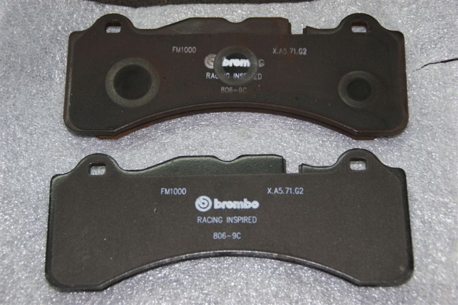

Emre, no they are working normal.
both problems are happening only when brakes are working under stress, I wouldn't call stress braking from 300km/h to 200km/h.
here are the pads.

I said I was exiting this, but I just can't let this thread continue to go on without.
I have stated earlier that the pads when new do experience a fade cycle before they recover and maintain their performance. This is stated in the product literature if one actually reads it.
A standard fade test for Brembo is 15 consecutive 70-0mph (112-0kmh) stops with no loss in performance.
The pads in these GT systems as standard are a fast-road and limited track pad. They are made by Ferodo and are an exceptional high-performance pad, while still having the comfort characteristics needed for street driving (i.e. not having your Porsche sound like a bus when stopping at street lights). There are other pads available, but there are trade offs between sustained extreme temperature performance and comfort. Customers can discuss their intentions and requirements/desires and the proper pad selected for their particular desires.
I have already pointed out that the system was not bedded properly and in fact, was done exactly contrary to the warnings in the literature. So this is our starting point. Then we have a "green" system that is improperly bedded and hasn't experienced the first fade. Then there are the extreme conditions which have not yet been mentioned, and I don't believe most fully comprehend. As I stated earlier, a standard fade test is 15 consecutive 70-0 stops with no time between with no loss in performance. I hope we can agree that this is aggressive use.
The OP is talking about 3 consecutive 300-200km/h (188-125mph) decelerations. Kinetic energy rises with the square of the velocity. This is the energy equivalent of 3 consecutive full stops from 140mph (224-0 kmh).
Is it unreasonable to believe that this could result in fade on system with street pads that haven't been seasoned?

About the brake pads I asked for:
DO NOT REPLY TO THIS EMAIL!
Dear 997 GT3 RS/TT,
You have received a new private message at 6speedonline.com Forums from vividracing, entitled "Re: brembo gt".
To read the original version, respond to, or delete this message, you must log in here:
https://www.6speedonline.com/forums/private.php
This is the message that was sent:
Trust me they are good. Video looks nice. Put your helmet strap on! You need one of my roll bars too.
Dan
---Quote (Originally by 997 GT3 RS/TT)---
I need it for race track !!!!!!
this is just ecu and exhaust.
---Quote (Originally by vividracing)---
Just 1 set of replacement Brembo street pads will be fine. I will send new estimate now.
Dan
