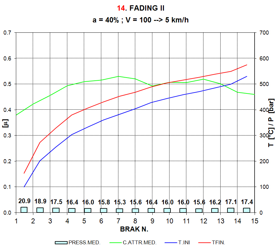

As you seem to be so adept at doing, you are ignoring all the salient points of the information provided, neglecting to take any responsibility for not reading and following the literature, and then proclaiming that it is someone's fault and/or there is product defect.
As I have stated several times, the pads in this system do exhibit one fading cycle before achieving and maintaining stable performance. This is assuming one immediately goes out and runs them hard. Alternatively with some time and regular use they will also be seasoned and achieve stable performance without ever having experienced fade.
In the attached graphs you can see these effects. There are 2 fade tests run with the procedure that I previously posted. 15 back to back stops. You can see that by stop #4 the friction coefficient is falling. However, the test continues. You will also notice that by stop #7 the friction coefficient has bottomed and actually starts improving again despite continued increases in temperature (blue is temp at beginning of stop, red is temp at end of stop). You can see the performance keeps rising right through the end of the test.
The system is driven to cool the brakes to baseline condition, and the test is re-run. In the second graph you can see that the performance does not fall-off.
