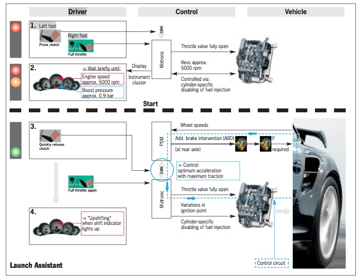

Function description
The Launch Assistant functions are embedded in the software of the engine control equipment (Motronic) and the anti-slip regulation (PSM). Control and adjustment are performed via the CAN bus.
When preparing for start by completely depressing the accelerator pedal, and when the throttle valve is opened completely, the engine speed is limited to approximately 5,000 rpm by disabling individual fuel injections. After the accelerated start, control is performed by comparing the actual torque map (determined from Motronic data and wheel rev speed in PSM control unit) to the target torque map, which is stored in the PSM unit and was determined by experiment. Differences between the actual and target maps result in control signals to the engine management. The engine uses these to vary the injection moment and disable or enable fuel injections for specific cylinders, resulting in the largest-possible transferable torque for optimum traction and acceleration.
In case of irregular wheel slip, anti-slip regulation supports the control system by using the electronic braking differential for wheel-specific braking. This ensures the best possible wheel traction.
As a result, the control units responsible for the fastest possible accelerated start are controlled in the best possible manner.
Combination with the PSM, SC OFF* and SC+TC OFF* control systems
For maximum and reproducible accelerated start, PSM should be activated (buttons SC OFF and/or SC+TC OFF not pressed), or lateral dynamics control (SC) be deactivated via the SC OFF button. With these switch settings, the engine control unit (Motronic) is active for maximum pull-away engine speeds of approximately 5,000 rpm, and anti-slip regulation with Traction Control (TC) is active for optimum longitudinal dynamics and traction.
Anti-slip regulation is completely deactivated when the SC+TC OFF button is pressed. With this switch setting, Stability Control and Traction Control, which is responsible for optimum traction, are both deactivated. This also deactivates the functions responsible for a simple and reproducible acceleration process: ABD (Automatic Brake Differential) and ASR (anti-slip regulation), and hence wheel-selective braking (ABD) and additional varying of ignition times and fuel injection modulation.
