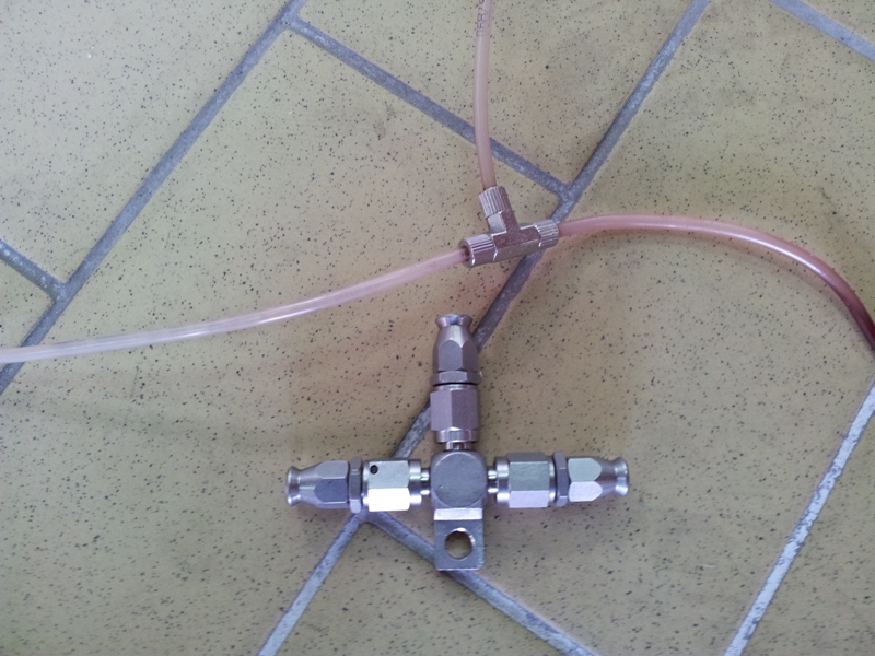

To use braided hoses you first need to buy the "AN" (LOOK) fittings from Howerton Engineering. The company that makes the Aquamist kit.
Even though they are not as good quality as they should, you have to buy them from there.
Picture 1
The two fittings on the left are to fit the nozzles and they are waste of money! The thread is so small it will brake before you use it.

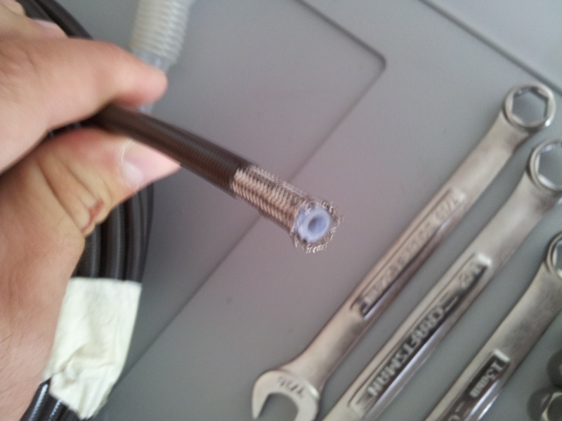

Here are some AN fittings in Stainless steel, braided hose and tools
Hose should be size -3 also the fittings should be -3AN
Last picture is for comparison of supplied T vs Stainless steel AN T

I have also changed the supplied nozzles to some better quality ones from "coolingmist"
It was a little difficult to fit them to the tube since there is not much space but i mannaged to do that by customizing some parts. You will need to find some 1/8 NPT female to fit the nozzle and on the other side it has to be AN male.
So you will need a 1/8npt (female) to -3AN(male)

I looked everywere and couldn't get the fittings for the nozzles, so i decited to make them.
I took a pair of stainless steel Ts, i removed two of the three AN male tips, and opened a 1/8 NPT hose at the pack which was flat and ideal (picture1)
(picture2) Ex T and nozzle screwed on the Y-pipe
