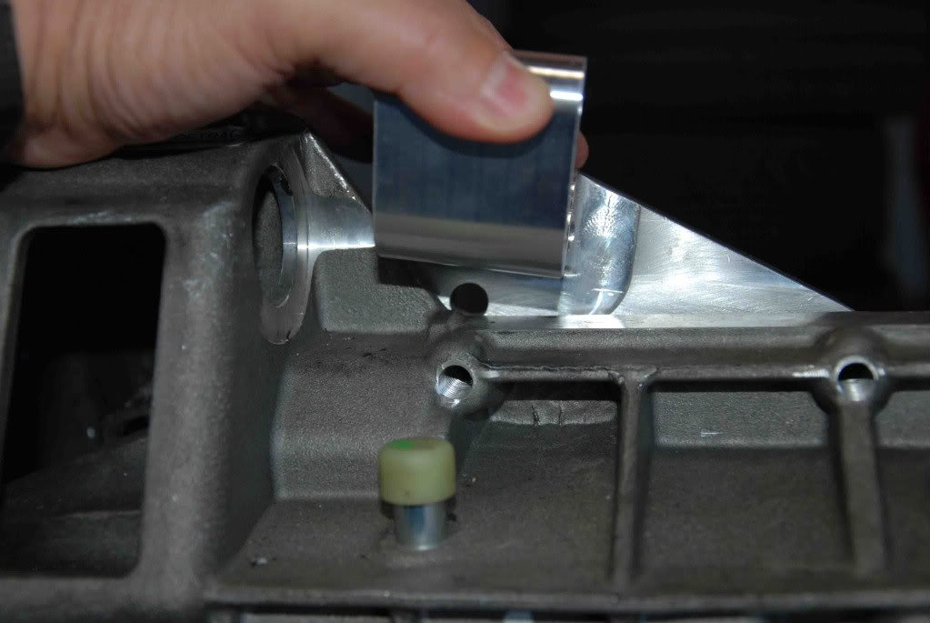

Originally Posted by zippsub9
The fifth part is the bracket that mounts the slave cylinder and dgreen78 is usually selling them on the classifieds from Seattle for $200..
Unless Don updated his bracket, it won't fit a 997t tranny case but the quality is superb.

TT dude, wasn't tracking the bracket misfit for 997TT Tranny case....bad news. I am sure there is someone else out there selling a bracket that fits the 997 Tranny case...
BTW...here are the other parts
996-116-237-90 Clutch Cylinder
996-423-377-90 Line (Non-Stainless Braided) I'm sure that makes a difference especially as all rubber lines wear and age.
996-423-171-06 Master Cycliner
996-423-081-18 Servofeeder
The bracket is needed to mount the clutch/slave cylinder to the tranny case and as TTDude expertly pointed out; dgreen78 setup works only for the 996 unless he has modified his setup. I will have to send a PM. You will need block off plugs where the hydraulic setup was fed in, but there is nothing special here. As far as I can tell the only thing additional the "kits" provide is a reservoir cap, not 100% sure how much this is or if it is absolutely necessary, don't know (maybe due to additional pressure in the system)
talisman13 has provided an awesome clutch DIY tutorial on here on a 996 TT and is very knowledgeable with this. I'm sure there is probably GT2 conversion DIYs on here as well, but I was going to do this when I had the tranny out. Not sure how much room you have only lowering the engine about an inch and tranny about three to four inches. It may not be enough room.
