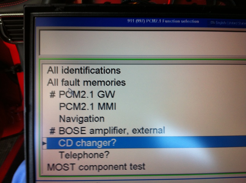

They have to use the PWIS to disable the 6cd changer, or the ipod player has to be rerouted in the loop. The same thing happened with my dennison unit.

Thanks guys. Winnilaker, so that I understand this process better: what exactly do you mean by "forgot to put the loop in place of the changer"? What is "the loop"?
Also, did you have to change something (with the "loop"), or just "disconnect the PCM longer" solve the problem?
I guess the questions also are what exactly are they supposed to do with PIWIS:
1. Are they turning off the CD Changer so that it no longer "exists"?
2. Or... are they telling the Car's Brain/ECU that there is no CD Changer, don't look for it?

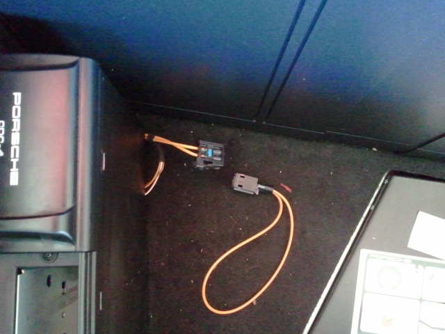

The unit came with a little loop that fits the MOST connectors. You disconnect the CD changer and use the loop to bypass the CD changer.

The typical setup for any aftermarket MOST iPOD unit is to replace the CD changer with the iPod unit. I am not aware of any setup that lows both a CD changer and iPod unit to coexist simultaneously.
The loop that is referred to above is used to close the fiberoptic circuit if you decide to plug the iPod unit somewhere else in the fiberoptic loop. As a changer and iPOD can not co-exist, a loop is used to close the fiberoptic circuit after you unplug it from the CD changer so there is no interruption.
PCM expects that the fiberoptic signal flow from one device to another in a certain sequence. Typically, the place to install the iPod unit is where the CD changer is located. The iPod unit essentially replaces the CD changer. Most installers (and DIYers like me) take the fiber optic wires (in and out) out of the CD changer, and plugged it into the iPod unit. The only time PIWIS typically is needed is to tell the car to activate the CD changer in cars that arrived without one from the factory. As the iPod unit is serving as a pseudo "changer," the car needs to know one is there.
Again, PIWIS is typically needed to tell the car to recognize a iPOD unit as a CD Changer in cars that arrived from the factory WITHOUT ONE. It shouldn't be needed to tell a car that already has PCM 2.1 to turn off recognition to the changer.
The only thing I can think of is that during the installation, PCM was turned on when the fiber optics were disconnected, creating a fault. You should be able to use PIWIS to wipe the PCM 2.1 gateway fault.
I am not sure if this can be done with the current version of Durametric. But PIWIS can run all the fault memories - if the error is there, then clearing it with PIWIS will probably get rid of the fault.

2. The only time PIWIS typically is needed is to tell the car to activate the CD changer in cars that arrived without one from the factory. As the iPod unit is serving as a pseudo "changer," the car needs to know one is there.
Again, PIWIS is typically needed to tell the car to recognize a iPOD unit as a CD Changer in cars that arrived from the factory WITHOUT ONE. It shouldn't be needed to tell a car that already has PCM 2.1 to turn off recognition to the changer......

With great help and instruction from Super Moderator Extraordinaire Bob (bbywu) I have been able to solve this puzzle. But don't ask us to explain why I was able to - we are left scratching our heads. The bottom line is that these after-market products could be temperamental and sometimes there is no logic or pattern to follow.
After failures from 2 dealers and Durametric, I finally decided with Bob's help, to pull off the plastic cover of the CD Changer to look. Once I pulled off the plastic cover, much to my surprise, there is already an after-market fiber-optic loop in there. This is that yellow little loop. The installer had pulled off the OEM cable from CD Changer and plug it into this loop. In effect removing the CD Changer from the system.
Instinctively I took off the loop and replugged the factory cable back to the CD changer, just like the way it came originally and that did it. It seems the Mobridge works without any manipulation of hardware (fiber loop) or software (Durametric). Why the loop was installed I have no idea; I believe it came with the kit so installer just put it there thinking it was necessary. In Mobridge case, that actually causes the alarm as PCM now cannot find the CD changer, hence "CD Changer not available," I think.
This is what I found when I pulled off the cover: OEM cable had been disconnected from CD changer and plugged into an after market loop. Basically installer had removed CD changer from the system - he should not have done this.
Loop was disconnected and the OEM fiberoptic cable was re-plugged into CD changer.

Can, I have to tell you, I still don't know why it worked.
Typically, Dension requires you to activate (not deactivate) a CDC setting. Also, Dension gets very unhappy with both the CDC and Dension unit connected simultaneously in the loop. It would seem that your installed did what most of us would do - program the CDC to "installed," plug in your MoBridge unit, and then close the CDC out of the loop.
Still scratching my head, but glad it worked out.
