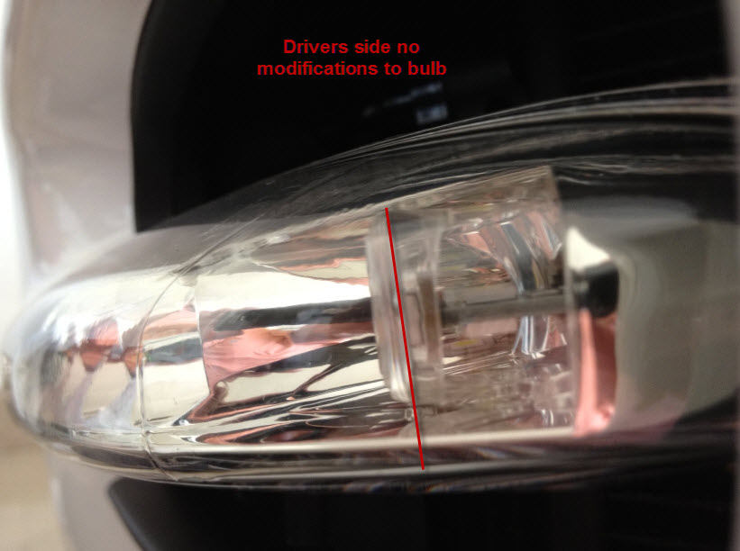

Inside of the led cluster is a lens that covers the bulb. What I am saying is I pushed one off when putting the new bulb in because it was too long. Take a look at your car!

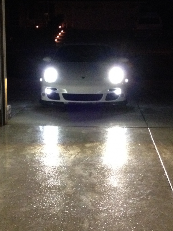

added another pic with headlights on.

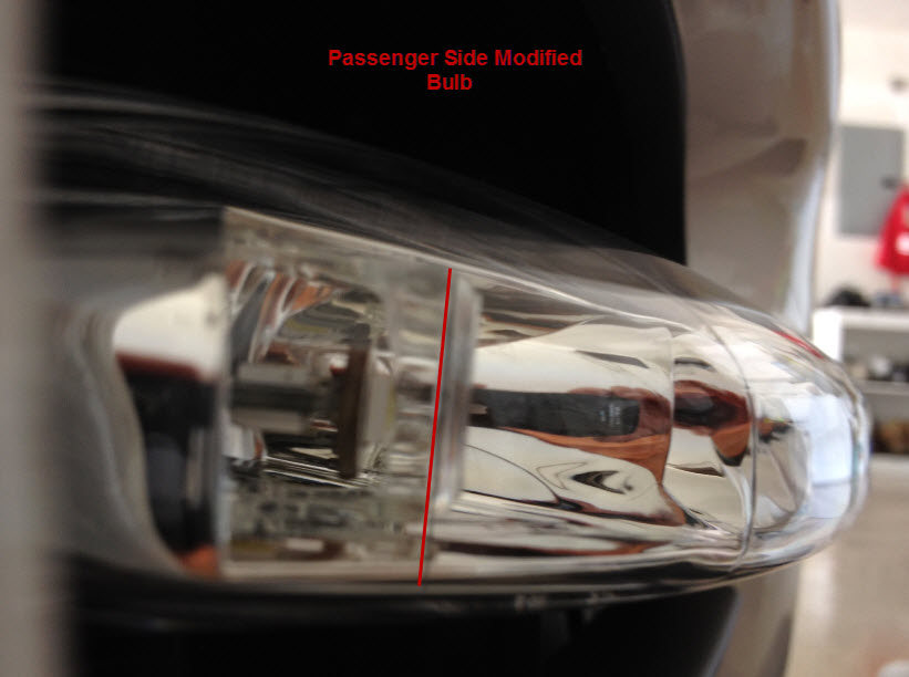

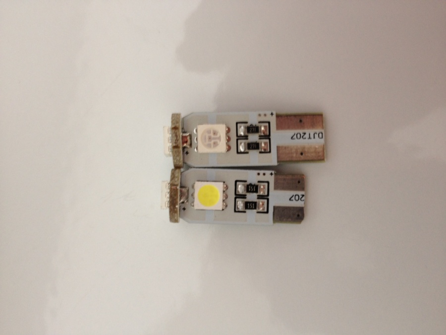

I took an orbital sander to the bulb and ground it down a bit. The contacts are long enough to allow for this. I've attached a few photos to illustrate my issue please note this is is only specific to the front city lights and no other bulbs. Also I'm not suggesting this is a Maxspeed specific issue I just want people to be aware.
Ive attached 3 photos:
1. Drivers side with no mods done to the bulb, note the vertical red line which shows the edge of the lens within the housing. Note how close the bulb is to the line.
2. Modifiied bulb on the passenger side note the gap
3. Side by side of "OEM" vs my griding action

It's really difficult to say we're talking about 1/32 to 1/16" between a perfect fit and popping off a lens. There is variance in the tolerence of the bulbs, my light strip, the lense within the light, and of course lets not forget the operator I didin't want to take a chance again so I modified it. I had no problem with the drivers side.

OK so I did the front lights, clear corners and license plates for now. I'm probably going to hold off on interior since you felt it was dim.
What I noticed as I was attempting to reinstall the front running light bulb fixture into the housing was that the LED bulb itself was pivoting between the connection blades because of the tight space, therefor when I started to lock the fixture while turning, it started to push on the thin leg of that notorious lens! I halted, back out, straightened the LED and went at it again and prevailed!

Nice now get those side marker bulbs in. So what do you think about how well it matches with the headlights? In my opinion an upgrade to 6k headlamps would match better.
