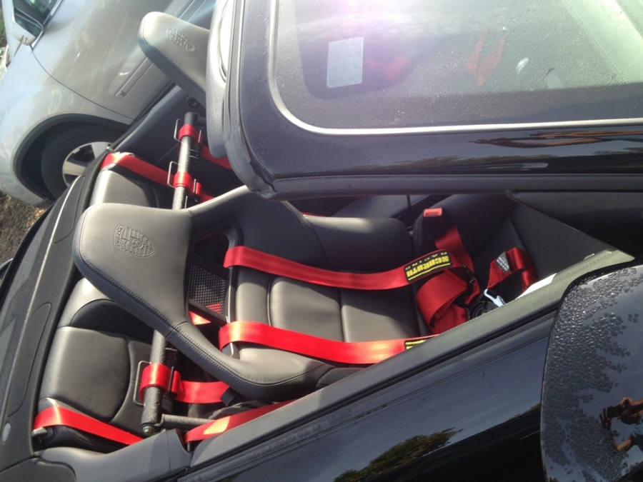

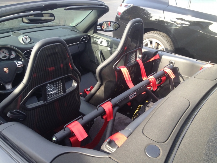

I want to thank Ryan and Suncaost Porsche for a 7 hour day on Friday installing new GT2 seats, Brey-Krause Harness Bar, and Schroth 6 point belts and a track alignment. This should keep me planted a little bit more at the October DE in Daytona

Out of curiosity, what do you do when you have a harness + normal belts? Do you fasten them both? I'd imagine otherwise you'd be getting the seat belt alarm all the time...

If you check the picture, I have both. I removed the harness from the drives side and left them hanging while I kept the passenger side intact until I have a chance to look at the install process in more detail.

Did you consider a full roll bar instead of just a harness bar in your cabriolet? What happens when you roll your car?

I did not consider a full roll bar. I have the factory pop up/out bars in the back if I roll. I also have arm straps to keep my arms in if I decide to drive with the top down, although I haven't driven with the top down. If I keep doing DE events as much as now, my next step will be a GT3

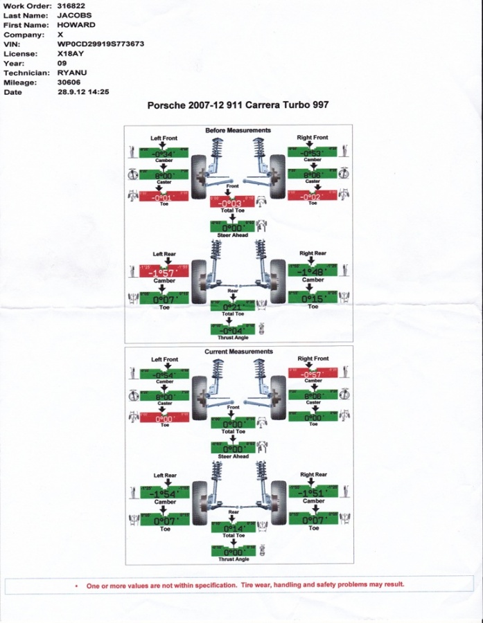

nice. what camber #s are you running?

Here is the printout. I didn't want to go to aggressive yet
